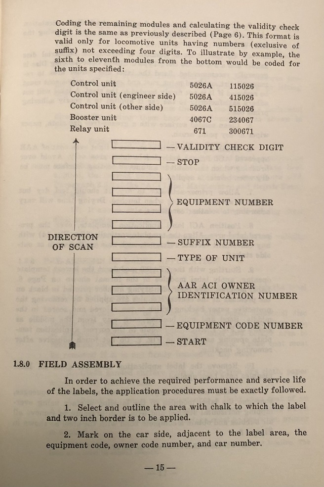

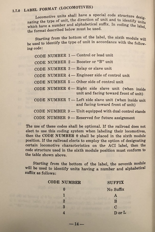

1. Per ICRR's page on ACI: "For locomotives, line 6 is the type of unit and line 7 the suffix number." How was this determined? What numbers were assigned to what unit, and what were the suffixes? Like S for switcher would be, for example 4? I have not found any documentation on this specifically.

I can provide an answer for question 1. See the attached images for the locomotive coding format for modules 6 and 7. Note that the use of these codes was optional so it would vary by railroad whether they were actually used or not.
This so helpful! I'm guessing this came from the official ACI handbook, what a jem!
Thanks!
