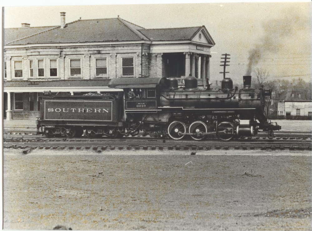

The pre-1926 passenger scheme was the same as the green scheme but with black paint. Passenger engines said "Southern" on the tender. Some switchers got the same treatment. There were likely a very small number that got decked out in green, but it was by no means common practice.

From my understanding the lined black paint scheme would receive Southern on the tender, instead of a number. This could be found on power that was tasked with switching passenger equipment at terminals, as well as passenger power in rare instances. The Southern seems to have started moving away from this scheme during the war, but a few locomotives got it as late as 1949 & 1950.

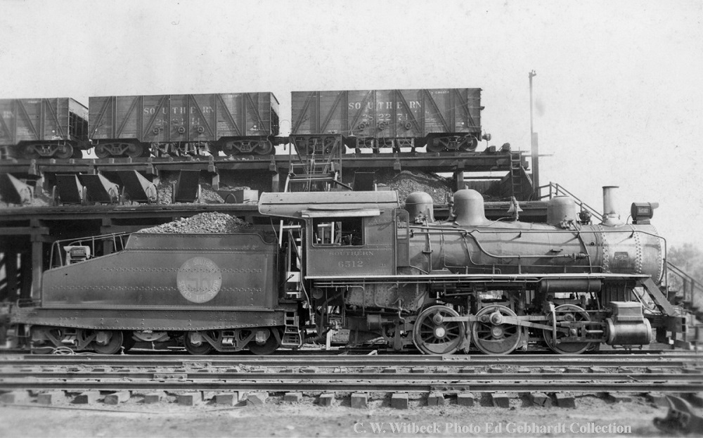

As to switchers in green, I've learned never to say never with the Southern. Attached are a few potential examples of this.

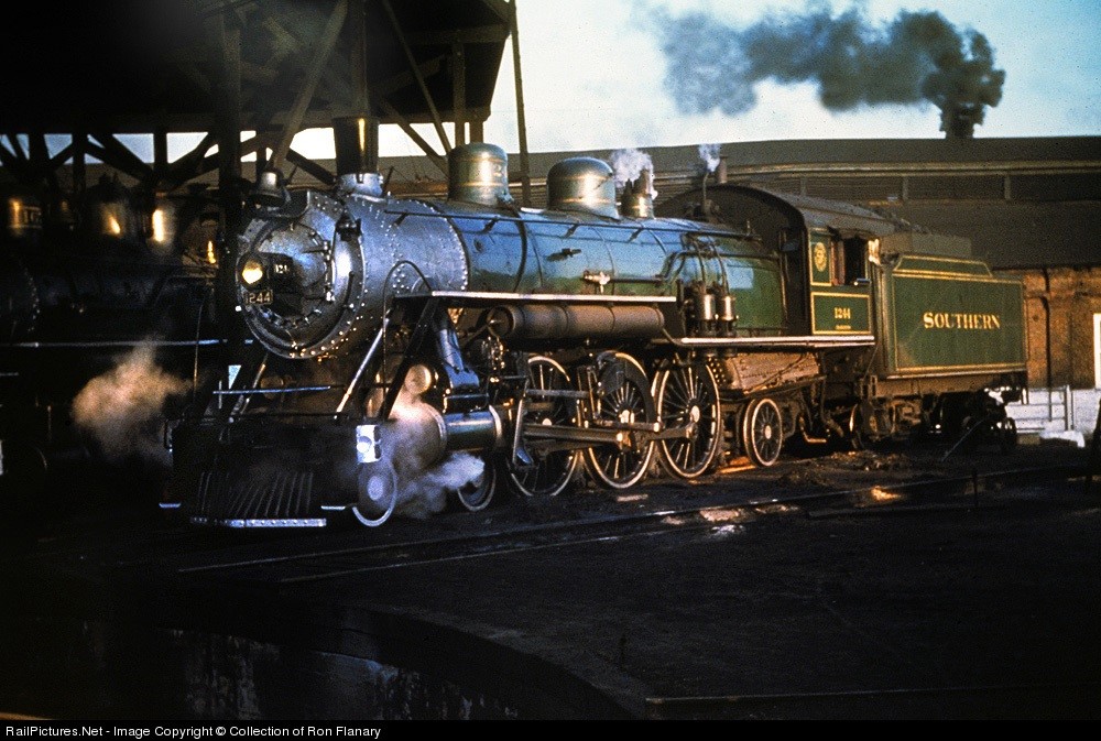

First is CNO&TP 6019, dated 1927. The locomotive is definitely in a non standard black scheme, but the potential clue to a green scheme is the stack, painted in what appears to be black. I've only seen this on locomotives serviced by Princeton shops, that carried green, like 1244, but I wouldn't be surprised if the lined black scheme could also involve a black stack.

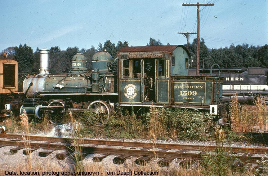

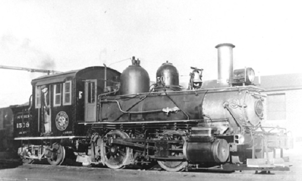

Second is 1509 "Old Maud". While the photo is more modern, she appears to be carrying a paint scheme given to it by the Southern, not preservation.The question being, is this an in service paint scheme, or a paint job after retirement? Other photos of Old Maud in service don't seem to show this scheme however.

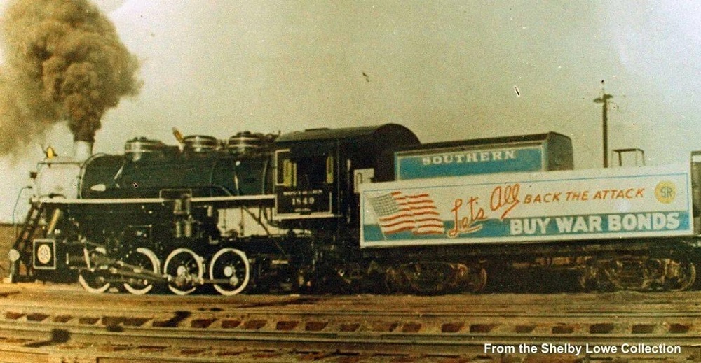

The final three, whilst not green, is more evidence that everything wasn't just a simple black scheme as most people envision it.
Like I've said, never say never with the Southern

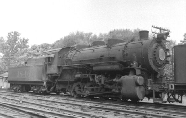

 Post subject: Re: Did the Southern paint some steam switchers green?
PostPosted: Fri Nov 11, 2022 8:40 pm
Posts: 636
I had no idea that was the predominant style before the numbers on the tender. My apologies if I’m asking a stupid question.
In the same collection of photos, I could see several switchers that did have blatantly different boiler jacket colors, but those seemed to be old continuations of the “aluminum” jackets the southern used to have
I probably wouldn’t had made this post if I had known the style was used routinely in the past. However, I have the feeling that I read somewhere, I don’t know where, that some of the Southern’s switchers were painted green at some point. Maybe that’s just me.
PostPosted: Fri Nov 11, 2022 9:33 pm
Posts: 343
No harm, no foul. I dont believe your original post was a bad question to ask! By no means am I a Southern expert, and Im still learning new bits about the Southern every time I do research.
I wouldn't say that lined black was the standard at any one time, rather that it was in the popular minority outside of the passenger pool. A "standard" black paint scheme, with numbers on the tender seems to show up in all eras for switchers. My guess would be that lined black was used at the discretion of each CMO/head painter, and not by a governing rule or standard.
Maud was never green, in service. When she was retired, the Pegram Shop workers went on strike for a day to prevent her from being scrapped. Incidentally, Bill Purdie's father was the local chairman. She was painted green and set on a pedestal outside Pegram.

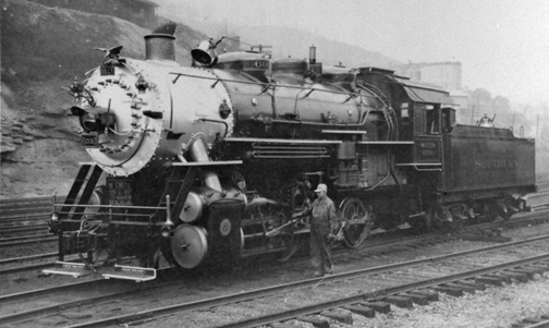

I believe the locomotive you are referencing was named Dolly. She was a USRA 0-8-0 switch engine at Oakdale, which her regular engineer dolled up. If the locomotive was painted green or not, I cant remember.
