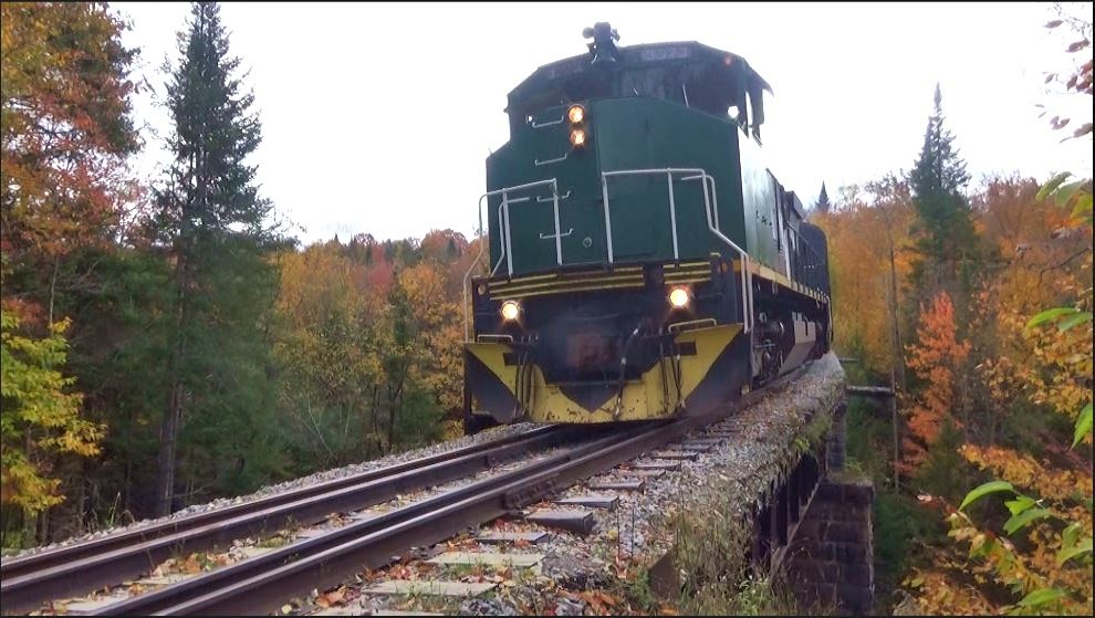

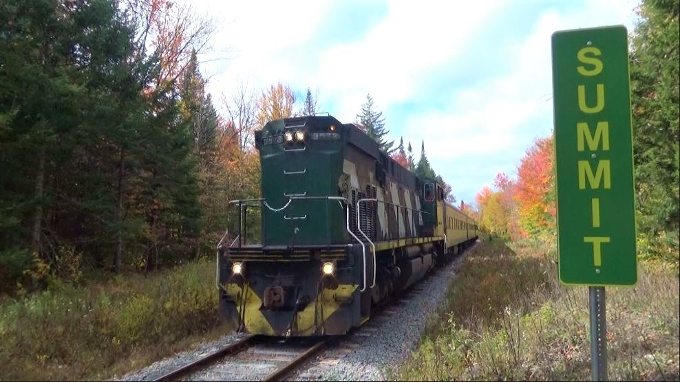

More specifically, a train is observed northbound over the Twitchell Creek bridge and, approximately 90 minutes later, the same train is observed southbound cresting the summit about 1/3 mile north of the former NY Central Big Moose passenger station.
A few screenshots:

Thanks for the continuing story and especially for the photos, for which I have a question...
It appears that Twitchell Creek bridge originally had an "open" deck, with rail directly fastened to the bridge timbers (whose ends appear in the photo). In the rehabilitation, the track was raised significantly, creating a ballasted deck over Twitchell Creek.
This would require a new "floor" atop the retained bridge timbers, which would be typically designed in the shape of a well, with shoulders to prevent loss of ballast.
Unless this is a "temporary" arrangement, can anybody advise how the shoulder ballast is retained in this structure?
I put your question to Doug Ellison, recently retired career railroader and a former superintendent of the Adirondack:
"As far as I know, Twitchell was always a ballast-deck bridge. It was way back in NYC days anyway and was not changed or altered by ADK RR or ARPS. As far as I can recall, all of the NYC Adirondack Division main line bridges were ballast-deck (except Kayuta), but not on the D&H Saranac-Placid side....The bridge has concrete retainers (or had in my day) on each side to retain the ballast...it was no different in NYC days in the 50's"
