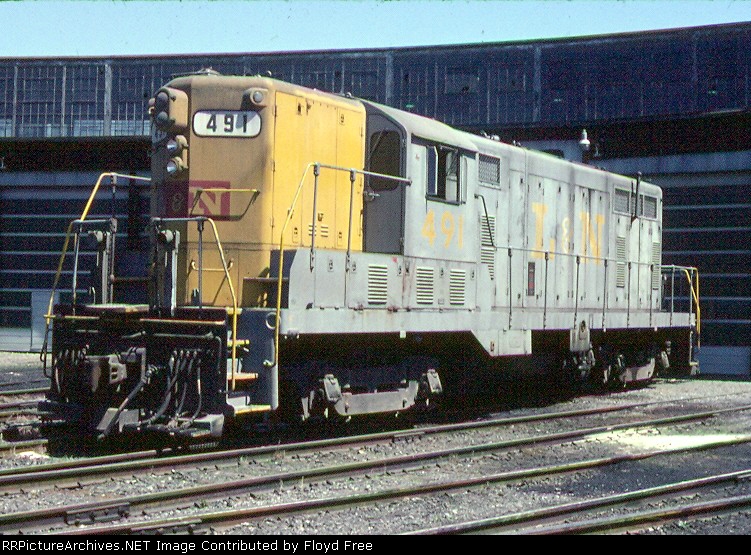

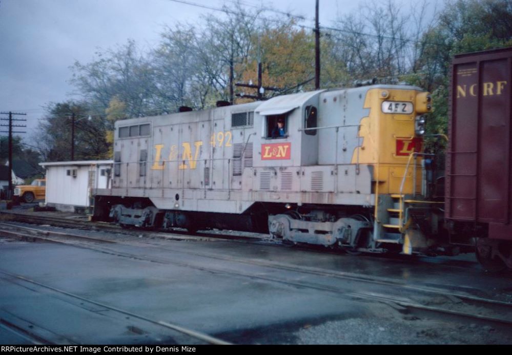

Edit: looks like all of L&N's GP7s with switcher trucks were ex-NC&StL. Here is #492, ex-NC&StL #702, and #491, ex-NC&StL #701, and a link to NC&StL #703 only, as the NC&StLHS won't let me copy and paste: http://www.ncstl.com/equipment/diesel/703.htm
491 GP7x Ex 1701 NCSTL 701 rdhse Radnor Yd Nash. 4-10-76.jpg [ 394.84 KiB | Viewed 6323 times ]
The NC&STL/L&N GP7s with switcher trucks originally did not have MU controls, but it appears the L&N added that feature to them. They ended up with a rebuilder, PNC I think, who added standard trucks to them.
Were the body bolsters any different on the GP7L, in such a way that it requires modification to fit Blomberg strucks?
