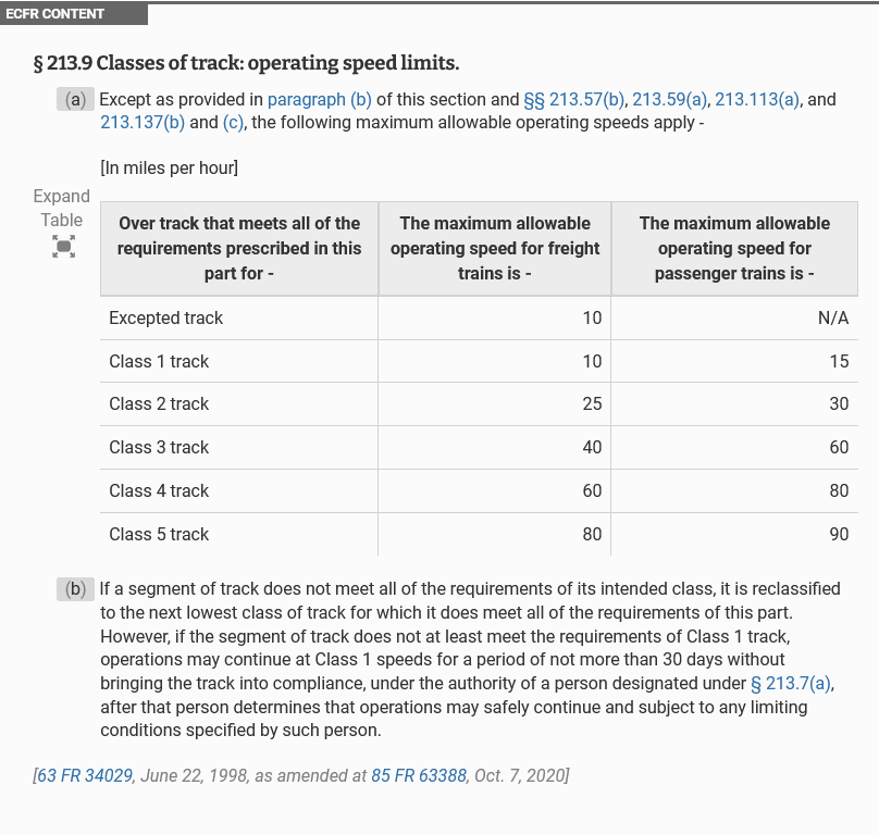

First things first –
When we’re dealing with railroad class a roman numeral (I, II or III) is an ICC/STB classification based on common carrier revenue. There are seven class Is (probably soon to be six) in the US: BNSF, CN, CP, CSX, KCS, NS, and UP). Railroads referred to as ‘regionals’ are generally class II. Everybody else is a class III. If you are not a common carrier freight hauler this doesn’t even apply to you.
Arabic numerals refer to track condition, not the company. 49 CFR 213.9 spells out the classes and the speed limits for each class. The lower the number the lower the speed limit.
Screenshot 2022-03-31 at 05-15-32 eCFR 49 CFR 213.9 -- Classes of track operating speed limits.png
Screenshot 2022-03-31 at 05-15-32 eCFR 49 CFR 213.9 -- Classes of track operating speed limits.png [ 86.82 KiB | Viewed 3168 times ]
https://www.ecfr.gov/current/title-49/subtitle-B/chapter-II/part-213?toc=1
There are a series of lawsuits which have been going on for a decade or so in a western state in part because when the original operating and lease agreements were written somebody used “Class 3” in the text when they should have said “Class III” (“The line shall be operated as a Class 3 Railroad”) and this was later interpreted to require track maintained for 40 mph instead of the much more reasonable 10 to 25 MPH.
