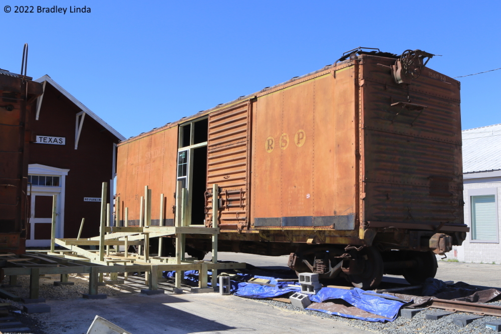

Les- here's a photo of RS&P 30 from today. On close inspection it has some serious corrosion issues on the center sill and the bottoms of both sides. Would I be correct in assuming from the looks that this was originally an outside braced car that was rebuilt? The last visible COT&S and reweigh was 12-62.

The car in the photos has all the earmarks of a steel rebuild of a USRA double sheathed boxcar. These USRA designed cars were the last big fleet of wood framed boxcars, although they were built with steel underframes and ends. In the thirties when these cars were due for major rebuilding, the Youngstown Steel Door Co. offered prefabricated steel sides to convert them to all steel cars and enlarge them to the then current interior dimensions, increasing the height by a foot and the width by three or four inches. Note the new sides are cantilevered out from the original side sills and the sides have an offset at the ends to match the original end panels, to which has been added an additional top panel. Some of these rebuilds retained their original height, while others had a flat panel added between the middle and top panels. This treatment of the rebuilt end can be used to determine which railroad did the rebuilding, my guess is the Santa Fe. This car has also had the roof replaced with an all steel roof.
An interesting car, not many (any?) of which made it into preservation.

I think you are right about this car being a rebuild of a wood boxcar. I have looked for a prototype photo of the car when the RS&P had it in service, but the only one I have found on the internet was on the Fallen Flags website and haven't been able to figure out how to post it here to RyPN. Which is a shame because the cars had a remarkably colorful paint scheme when in regular service. Hopefully the folks there in Belton, Texas will paint the car that way. As long as the car remains stationary, the center sill and side panel corrosion problems can be addressed, and the car made into a welcome attraction to visitors.

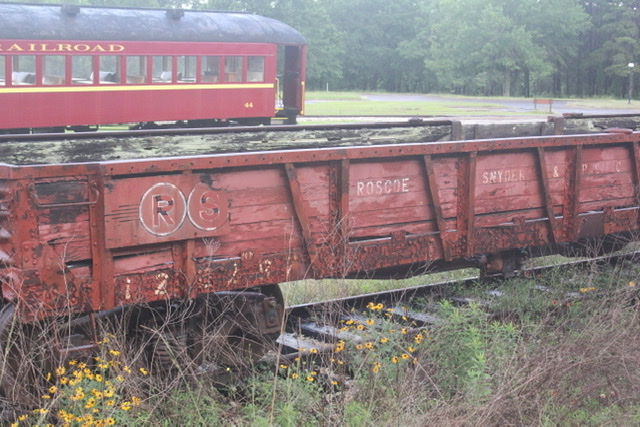

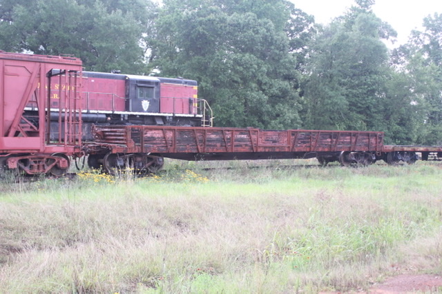

Here is a flat bottom wooden gondola that has been at the Texas State Railroad for many years. It’s numbered RSP 125287. It appears to be a possible conversion from a wooden box car.

Although I couldn't figure out how to post the prototype photo of the boxcar, I was able to find a photo of an HO model of the car that Atlas put out way back in 2009:
http://www.archive.atlasrr.com/Images/H ... 4-1_TQ.jpg
The colors shown on the model, are the same as on the protype car. Also note that Atlas confirms this was a model of a rebuilt wood car.
donaldcurtis -
Thanks very much for the info and photos of the RS&P wood gondola at the Texas State Railroad. Nice to know that there is another artifact from the RS&P. Hopefully the TSR will take a bit better care of the rare preserved car.
