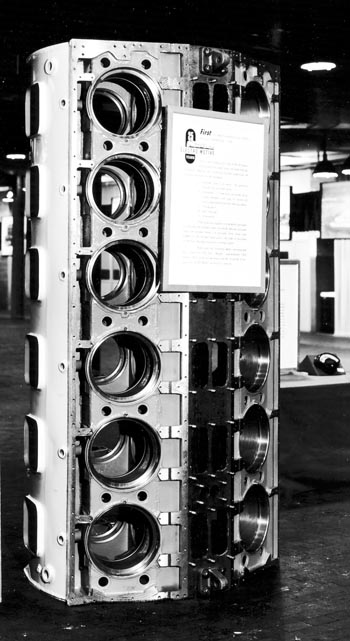

EMD Displays – Crankcase Standing On End
This display was shown at the EMD 1947 Open House. It was a new EMD 567 engine crankcase borrowed from production, that was used in a new locomotive after the event.
The EMD engine crankcases are intricate structures and quite impressive as this kind of display. The advantage of vertical display is that the crankcase requires very little floor space. The disadvantage is that this imposes a tremendous weight load on a small area of floor.

Indeed, an amazing assemblage of pieces, then precisely machined. (I have the print version of your Inside EMD series.)
Now we are left to guess if this one ended up inside an E, a switcher, or some non rail use.

My older son (a welder) at first did not believe thees to be all welded, until at an open house at La Grange he saw one as well as the size and amperage of the equipment they had.
 Post subject: Re: EMD Displays – Crankcase Standing On End
PostPosted: Sun Feb 27, 2022 1:41 pm
I learned they were all welded via an article in Trains Magazine in the mid-1960s, which covered how the various stock was provided and prepared. I was indignant that it was merely 'welded together' instead of being cast the way I knew automotive engine blocks were... but that's a seven-year-old's perspective. ;-}

Really just a framework to hold the PAs, crank, and cams, etc. And all the other things you need to hang on to it.

Interesting to see one sitting on end like that. I have heard stories of Stewart & Stevenson converted a few EMD's to run like that for the oil field, but have never seen the photos.
I have seen plenty of converted 6, 8, 12 and 16V71 engines converted to run on end like this running pumps. Very odd seeing it and reminiscent of the 184, 338 and 358 engines, just smaller.

The experimental submarine Albacore, on display in Portsmouth NH, has a pair of GM 16-338 engines, standing on end. Built in an X configuration, these were not the most successful design. I have toured that sub; engine room is not much bigger than a large closet. Interesting sub and history, worth taking a few minutes to look into.
