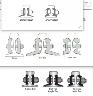

I never heard of tie plates being confused with joint bars, but fish plates are a specific style of joint bar as are angle bars. Fish plate is another name for splice bars - an older style no longer used in modern mail-line sizes, but some older track guys I've spoken to had heard of the term. Here's a screen grab of bars from three different (US) suppliers' source books. The most common terms I hear today are the ones in the middle illustration. Note the older style isn't even shown anymore in the top one.
I have another older manual that specifically shows the plain fishplate (splice bar) style labeled as such but can't find it at the moment.
G.

I agree that I've also seen catalogs with fishplates having no toes and just fitting in the fishing surface (web) between the head and the base of the rail. Angle bars covered a lot of the top of the base, and some even folded under it!

Do the catalogues show anything which would be the equivalent of a "junction plate", which is for joining different (as opposed to worn) rail sections together. The tricky ones are those which join bullhead rails to flatbottom, which roughly speaking change from splice plates to short toe plates in the middle.
 Post subject: Re: A Switch By Any Other Name ……..
PostPosted: Fri Feb 11, 2022 3:10 pm
Posts: 1755
The catalogues have Compromise Joints for connecting 2 different rail sections. Many are cast, but I've seen some that were forged or ground down from a regular bar for the larger section.
