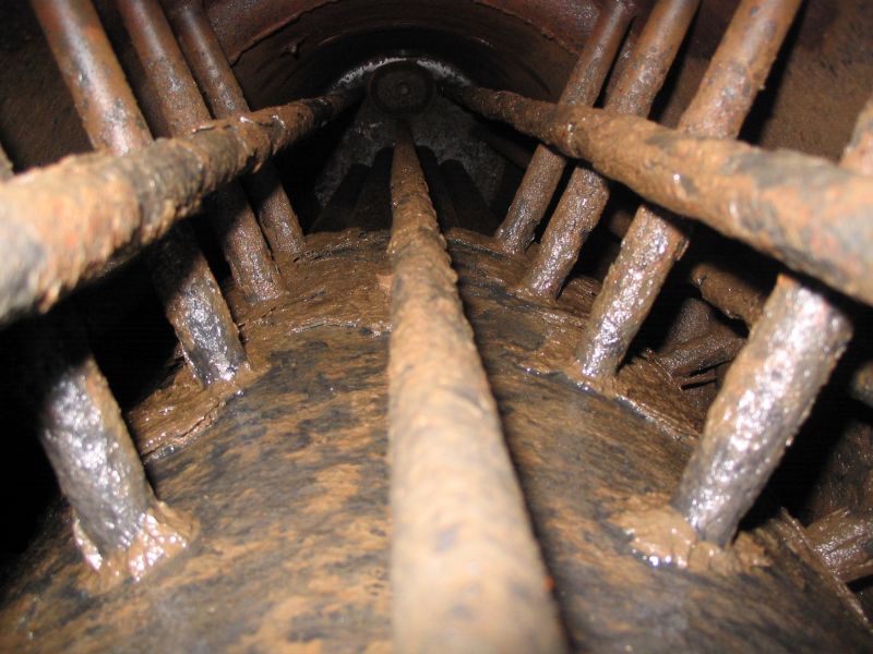

Hello All,
Hoping everyone has a Good New Year.............!!!!
Thought we might examine these two pictures showing the results of corrosion at the base of the stay bolt where it enters the sheet....
Inspections can be rather deceiving sometimes without some exploration.
You thoughts, please...................
Take care................
Dave

In the lower picture, I have worked on boilers like that in the distant past.
It would be interesting to have the stay bolt pitch, ultrasound of plate thicknesses, etc..
We had a similar situation, probably about the same appearance of necked stays. After examining other parameters, the Inspector requested some stays be renewed. We replaced the worst using threaded stays and opening the holes one size.
I am not sure now what the necking allowances are, but sometimes those things look worse than what they are. Certainly one or two there look to be necked badly.
A lot more work is required on the boiler before one needs to worry about the stays.

I certainly wouldn't claim to be an authority on boilers, but I'd have to say that looks pretty nasty. You won't really know what you've got until you can get all the crud off everything. One method is needle scaling, but how are you going to get inside there with a needle scaler ?? I've heard of using a diluted solution of carbolic acid and water to remove heavy scale buildup, of course you would need to wash the boiler extra good afterwards, and you should be advised that this will most likely open up everything which is loose and leak prone. Some old timer boilermakers say that a bit of scale seals up your boiler, just like some old mechanics will tell you that old, worn out motors run better if they have a bit of sludge in the crankcase. Clean it out, and you'll see what's really wrong... just be careful what you wish for. (And best of luck to you.)

Crevice corrosion at the base of stays in the water space is something that is frequently hidden by scale, and it doesn't take much scale to cover it up. It's also a common find, particularly with some threaded stays or welded stays with improper root penetration. A trained and experienced eye is critical for an internal inspection, or inspection of any kind. This type of deterioration next the the staybolt is also why you'll see many UT measurements taken inside the firebox up against the staybolt to look for this. In my experience, right next to the staybolt is often where the thinnest measurement is found, even if there isn't severe crevice corrosion like is seen here. I've seen inexperienced individuals attempt UTs, where readings were exclusively taken in the area between staybolts, missing thin spots next to staybolts, or missing thin spots in other areas prone to crevice corrosion, pitting, or grooving- such as at the bottom of the firebox sheets at the mudring. Thoroughness is a virtue of boiler inspections.
Obviously this is particularly concerning to find in a boiler when severe, as the loss of material as seen here not only reduces the sheet thickness, but also reduces the amount of engagement between staybolt and firebox sheet. Lose enough engagement on enough stays, and there won't be adequate structural support for the sheet.
