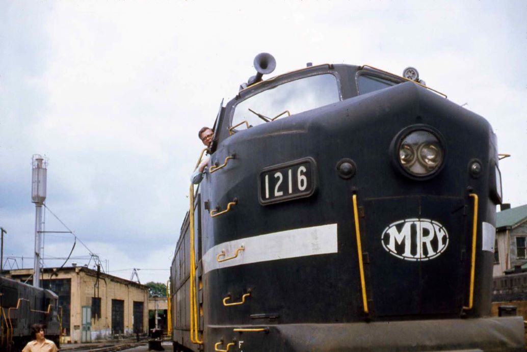

I'm not sure what the consensus is about hoarders, whether they end up furthering rail equipment preservation or hindering it, but I dislike being trolled.
82001054_10163213995440529_2332285112810471424_o-c.jpg [ 74.33 KiB | Viewed 19814 times ]

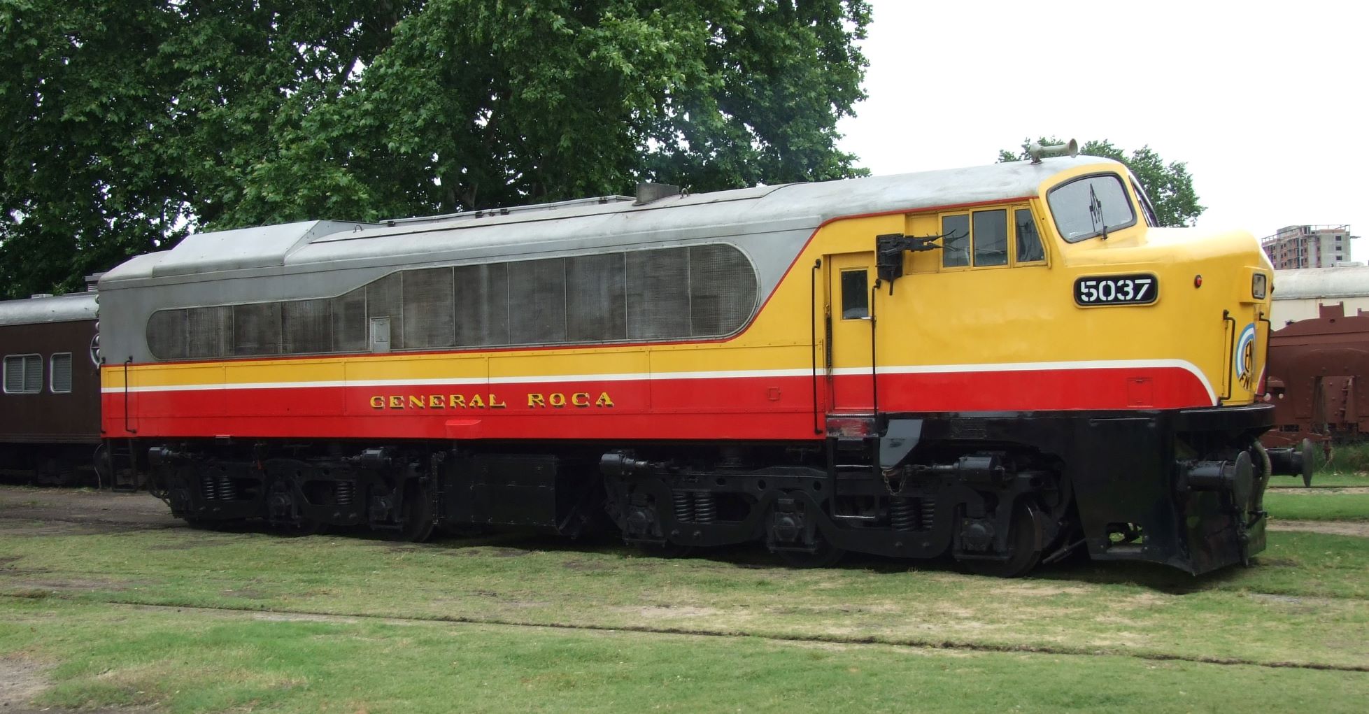

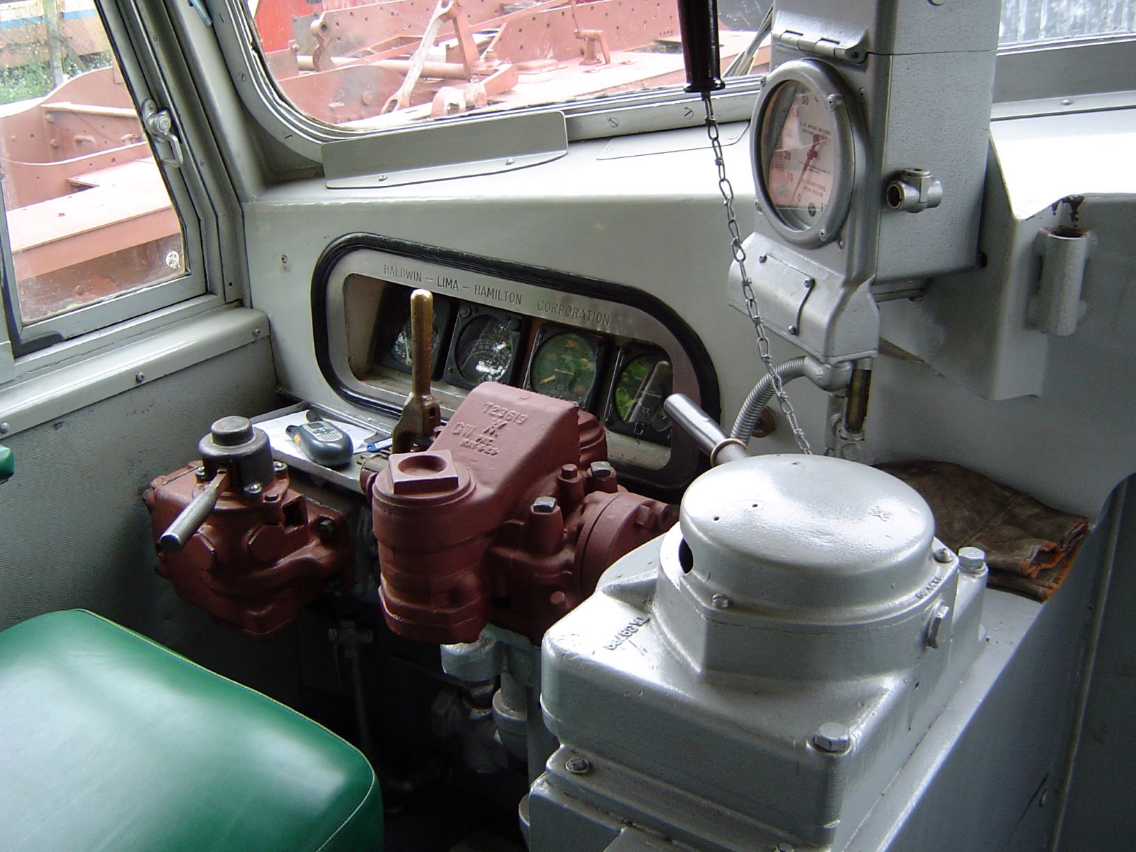

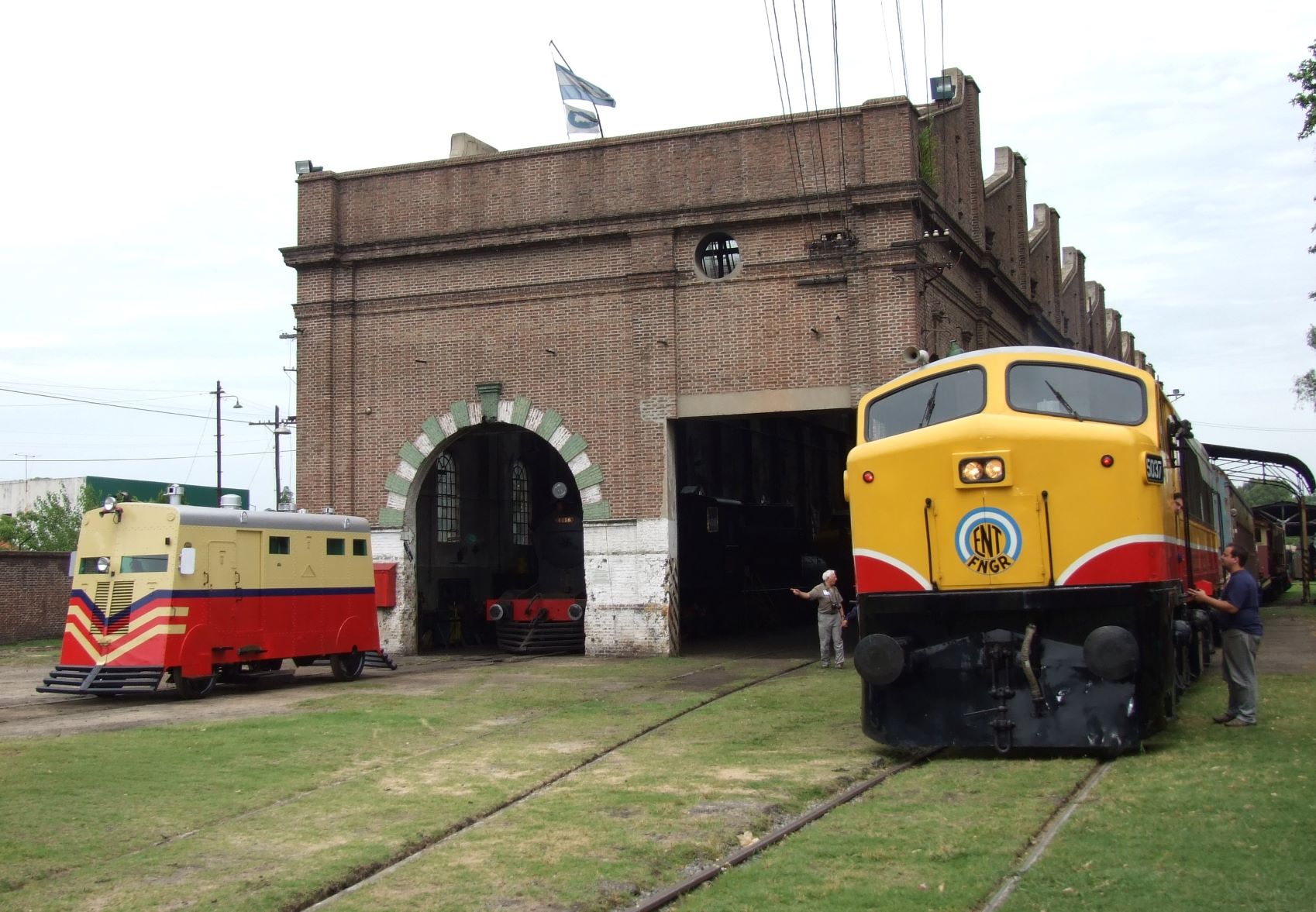

Not quite the same, but don't forget there are some Baldwin RF615E broad gauge locos with a "sharkish" style front end preserved in Argentina.
This one, preserved by Ferroclub in Buenos Aires, was certainly operational in 2007.....

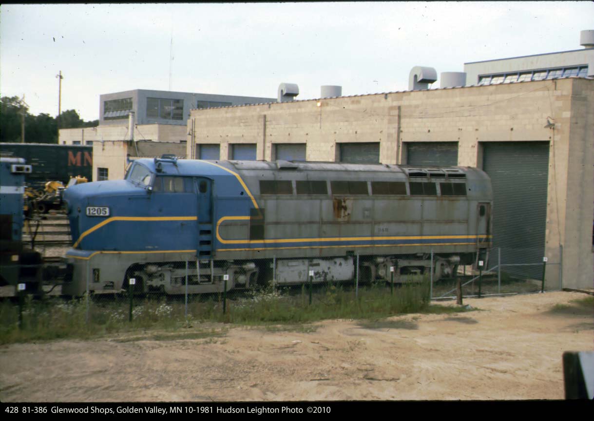

Was looking for something else and found this:
