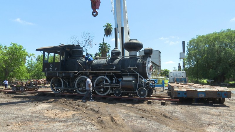

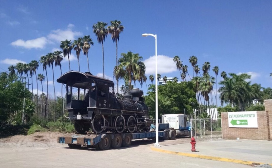

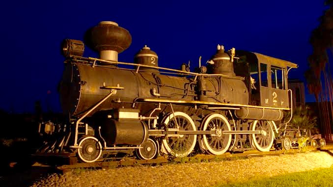

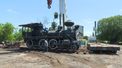

PS The locomotive was relocated within Los Mochis in 2016. Here are some pics from the old location and the move...

Twenty five years ago, I had the steam dome tag from this engine in my filing cabinet. I can't recall all the data, other than that it DID confirm the SPdeMexico number was #208. I have a message in to the current owner, regarding the history of #2.
What I CAN tell you is that isn't the original smokestack for MdelP #2, but rather it was removed from MdelP #4 when she was converted to oil. After awhile, the tender from #2 was transplanted to #4, because her original wood rack type tender was so long that it frequently fouled the cane trucks and trailers in the mill yard.
