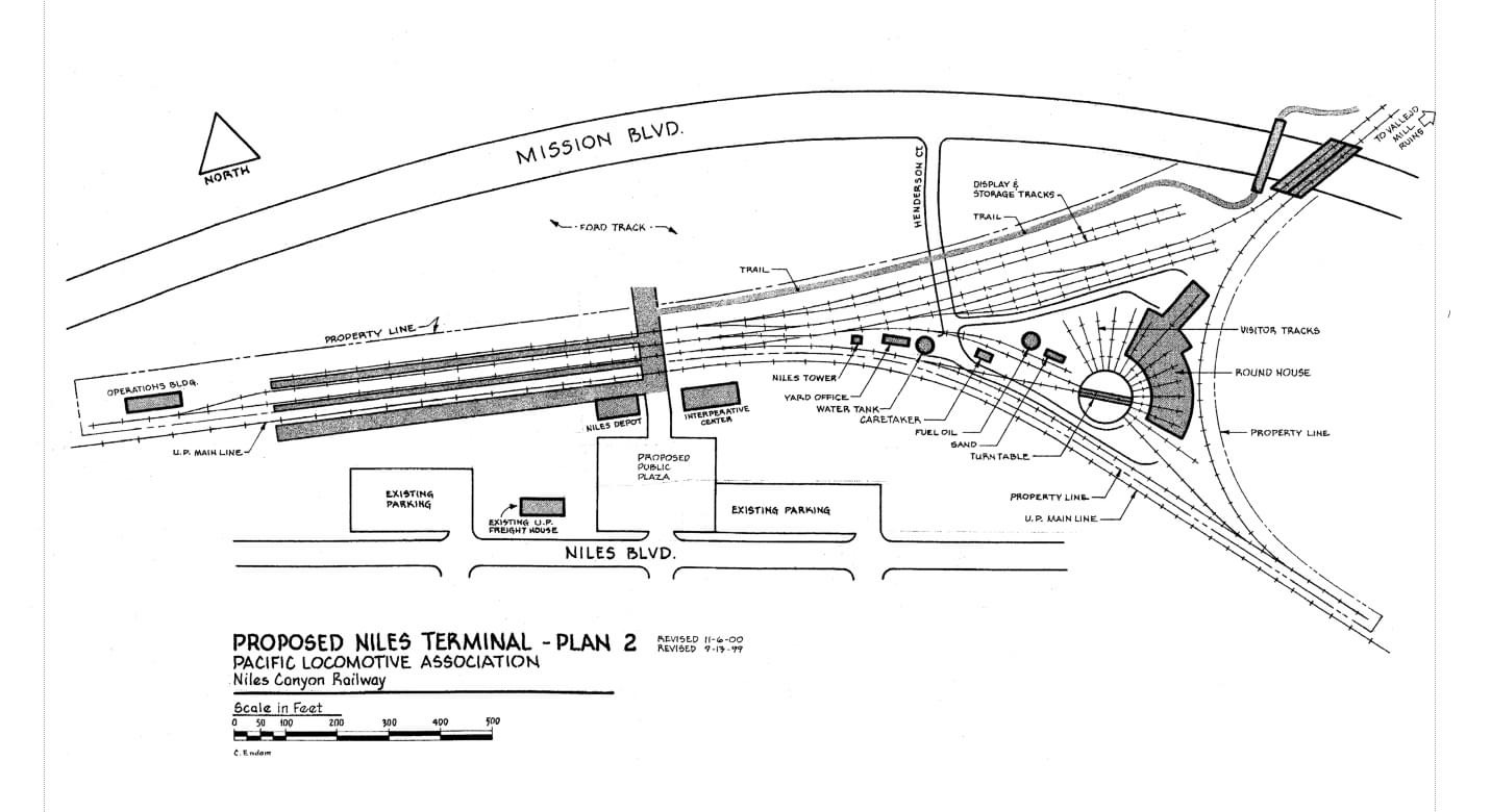

Brian Norden wrote:
About six years ago, I recall being told that PLA had desires to install an engine house and exhibits at the wye at the Niles, CA end of its line.
Proposed Niles layout from PLA’s Master Plan created twenty years ago.

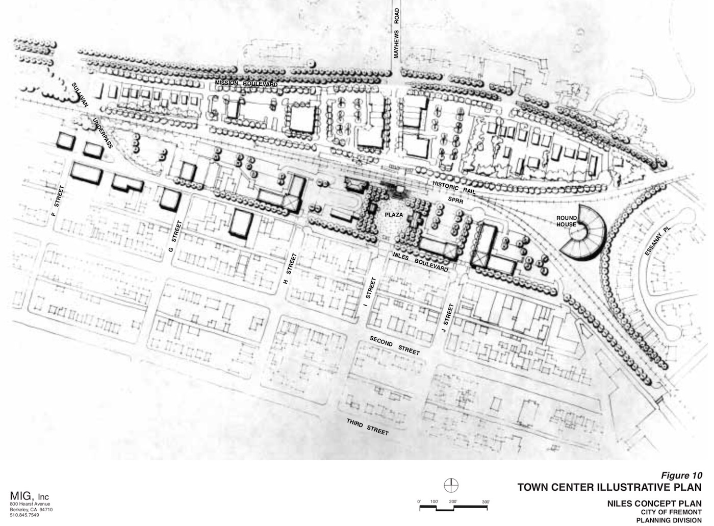

The roundhouse was not only featured in the PLA/NCRy's Master Plan; the City of Fremont's Niles Concept Plan from 2001 embraced the roundhouse as well.
These plans also suggested that use of the SP Niles Depot and access across what are now the UPRR tracks would be central to connecting the NCRy's trains to the town of Niles. Unfortunately, there is still no way to cross the UP at this location, and the depot was relocated to the newish Niles Town Center to face the town, not the railroad. As a result, the full benefit of the railroad's presence is not available to the local merchants and the NCRy has had to provide parking on its side of the tracks. Resolving this is another long-term issue that the railroad needs to address.
File comment: Fremont Planning Department Niles Concept Plan
Randolph Ruiz
