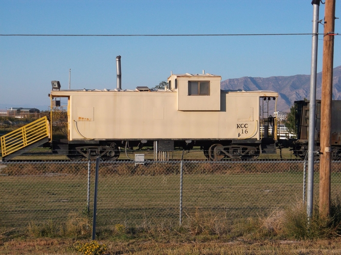

This may be a stretch, but is there a list anywhere online for cabooses built by International Car in Ohio?
In particular I am looking for the history of Kennecott Copper's caboose 426, an extended-vision cupola caboose which showed up on its ore hauling railroad in Utah in the early 1990s. It is *not* the former Nevada Northern's caboose 6, which is still at East Ely in Nevada.
Kennecott 426 is preserved at the Deseret Peak motor sports complex near Grantsville, Utah. It has been renumbered as KCC 416. Attached is Matt Liverani's photo of 416 as it appears on display.
File comment: Kennecott caboose 416. Matt Liverani photo.
Kennecott-Utah_Caboose_416_near-Grantsville_Matt-Liverani-photo_700.jpg [ 286.01 KiB | Viewed 6194 times ]

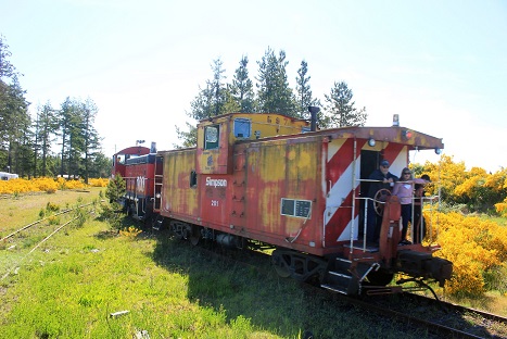

Simpson caboose #201 was ordered by the Chehalis Western Railroad (Weyerhaeuser) with purchase order #CW072271 as Chehalis Western #597, along with sisters 598 & 599, on June 20 1981 from Paccar. It was built by Paccar's subsidiary International Car at there Kenton Ohio plant for $80850.00 each. These three cabooses would be among the last produced by Paccar. Now in care of the Peninsular Railway & Lumbermen's Museum it is giving rides this memorial day weekend out at Simpsons former dry sort yard. [img]
