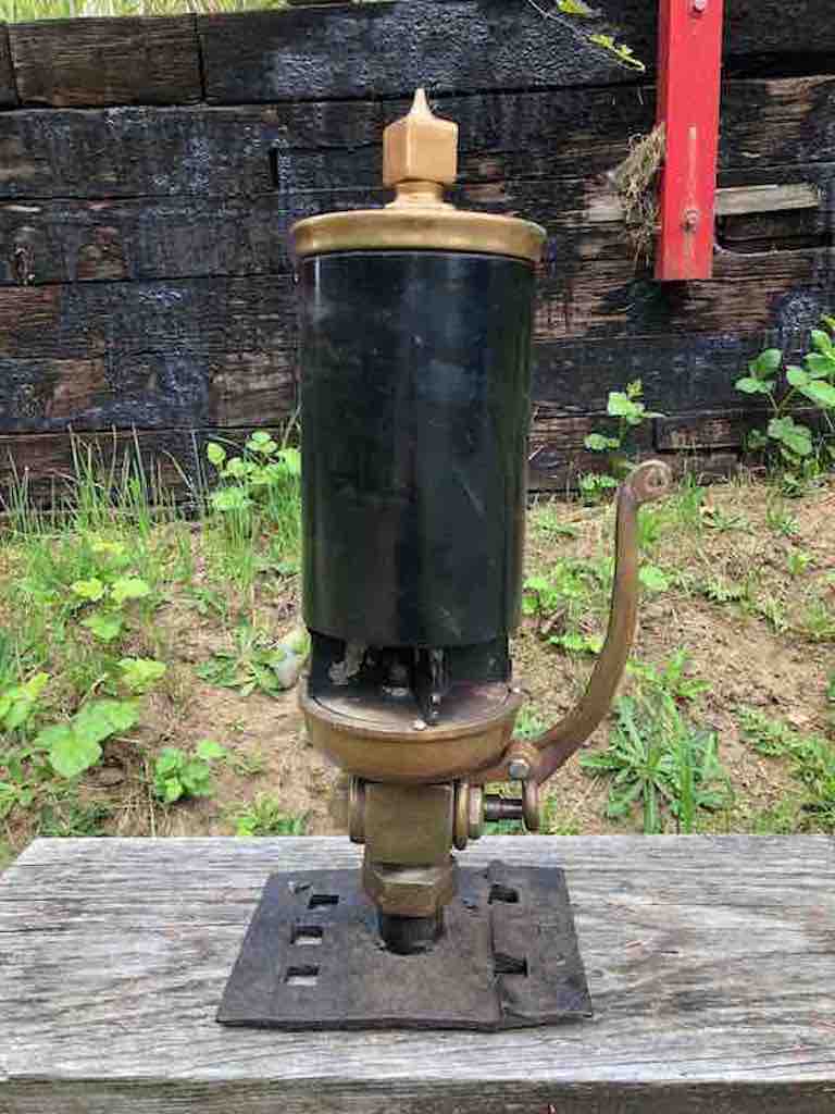

Here is a Kinsley whistle (6" dia.) which was used on Hillcrest Lumber Co Shay #1 during the 1990's, it did not carry this whistle during it's working life. We are not sure where this whistle came from but it is entirely possible it is the same one Tom mentions above on 1055. It had been painted silver overall before we put it on the Shay, the bell on this whistle is steel, I'm not sure if that is original or a repair. We also had some oral history that this whistle may have come off a CNR engine, though I find that doubtful. This is an absolutely lovely sounding whistle so I think we will be putting it back on the Shay when it returns in the near future.
Pat
