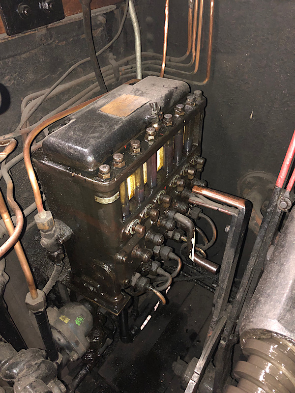

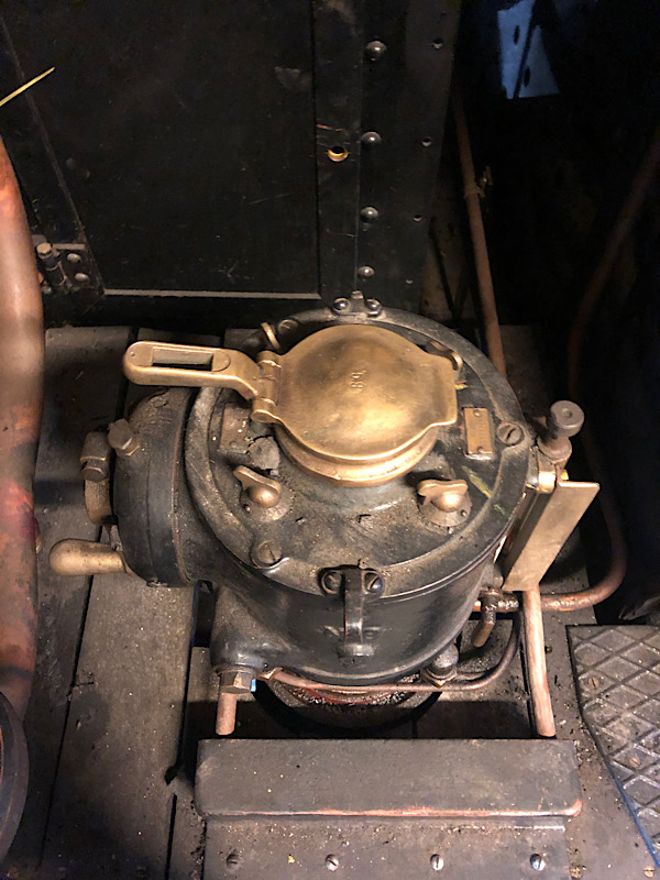

Agreed - but if any of you out there are like us, the pump you are installing has been sitting out in a boxcar for 60 years. It came off an unknown locomotive in a scrap line. It is covered in rust and dried oil. You have no idea how it will perform. It will require adjustment and observation.
We recently (3 years ago) did this with our current tank engine restoration. We made up a test stand to test the pump. This European pump has external adjustments and sits in the cab, so at least we can make adjustments as we go during the day.

Here are the lubricators in our current active and nearly active fleet:
File comment: Lubricator in Helsingør Hornbæk Banen no. 4, 4-6-0T
File comment: Lubricator in Swedish railways (SJ) 2-6-4T no. 1307.
