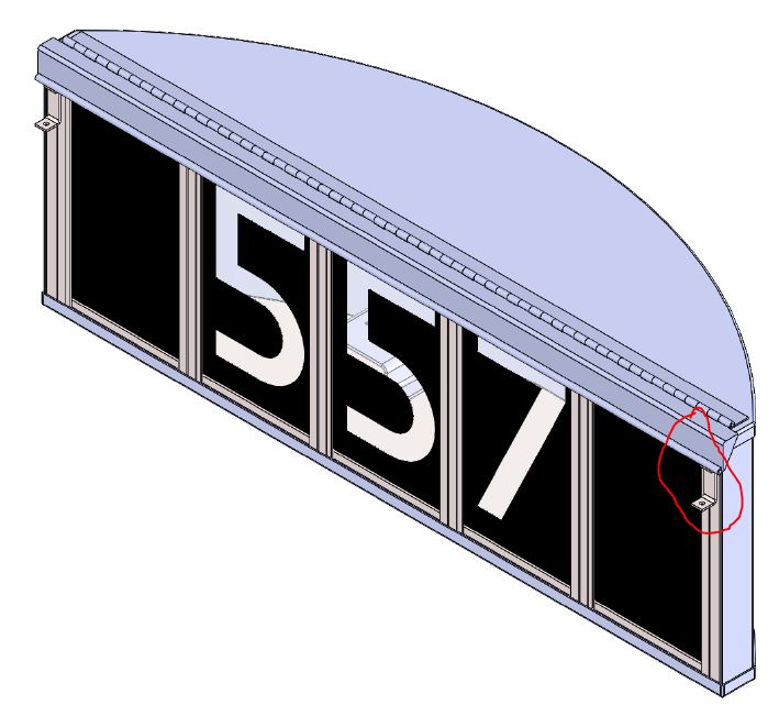

I am working on a project to replicate these angled number boards on two of our Alco RS-3 locomotives, Boston & Maine #1508 and Maine Central #557. I have the best of the lot sitting on my office floor and have created a design in Solid works. However I am missing at least one detail, that would be where I have circled in red in the drawing. there was some type of latch or hook here, long gone once the hinges rusted and the cover didn't need to be lifted, probably until both bulbs burnt out.
the construction on my sample is soft soldered construction, and depending on finding the right vendor may be again, or welded. defiantly will be made of stainless.
I am thinking these may be of a similar design used on steam locos as well, SP , UP?
so what I am looking to find is a good photo of the latch, or drawing documentation of the whole thing.

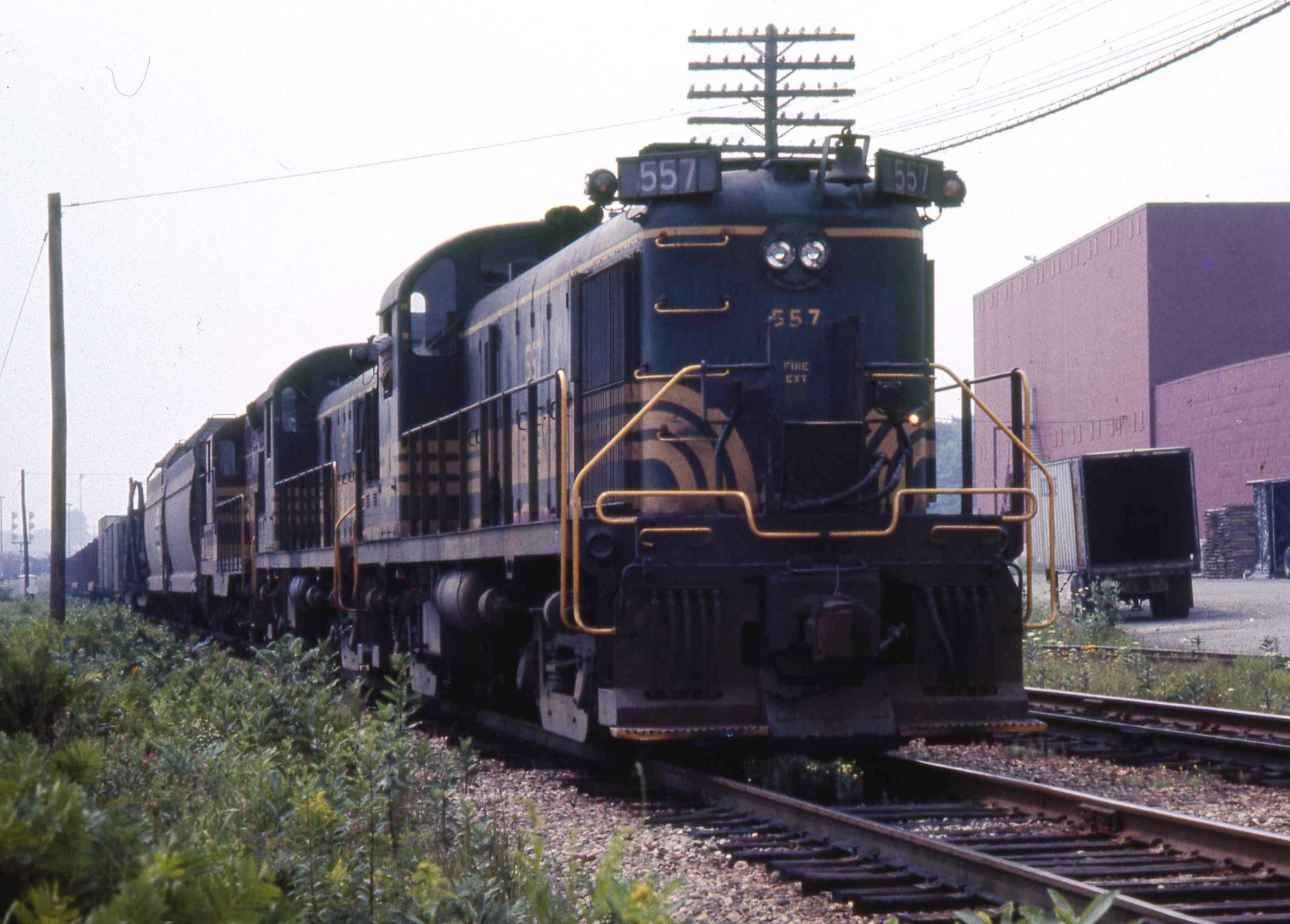

Not the most detailed shot of the number boards, but shows classification lights with them. Your locomotive, on an eastbound road job, doing its work in Waterville yard.

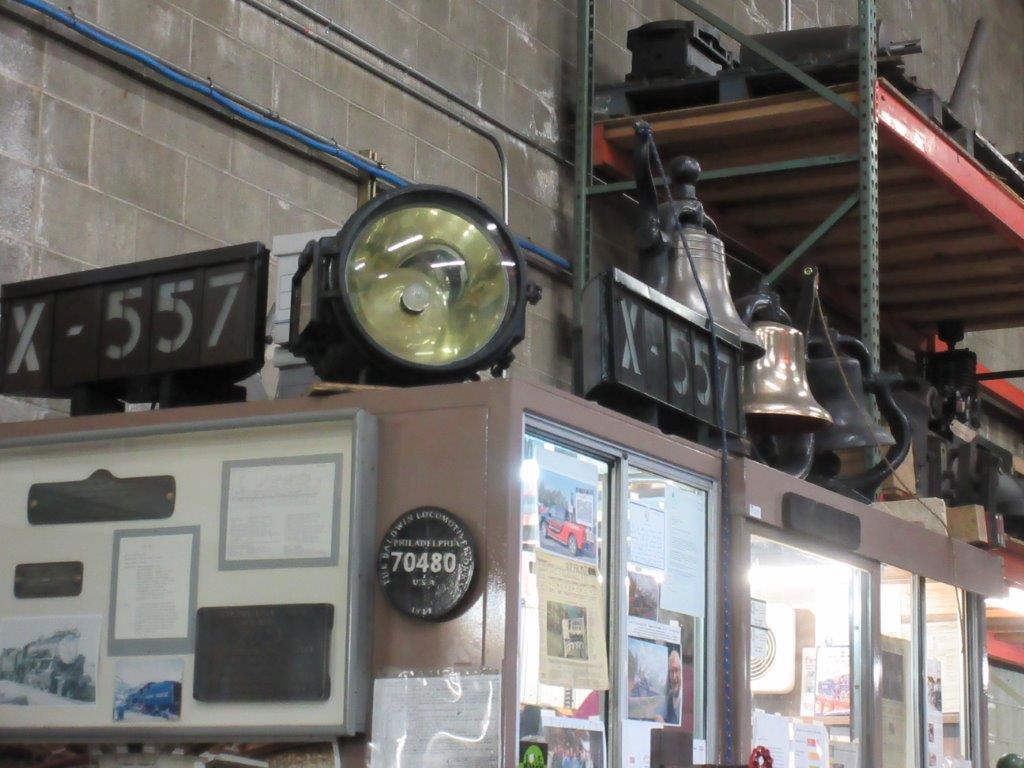

You might try contacting the Mid-Continent Railway Museum, They may have an intact example:
https://www.midcontinent.org/equipment-roster/dieselother-locomotives/milwaukee-road-988/

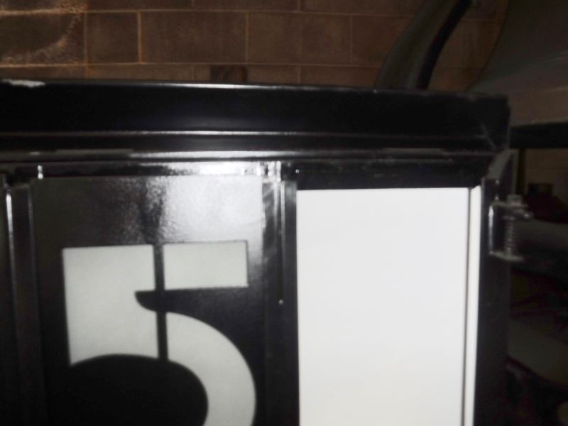

From Engine 557 Restoration Company President and Project Manager, Patrick Durand -
Here are some photos of the right side and corner of our Harriman number boards and the latch assembly with the weather cap both open and closed.
If this of any help, we can take the unit down from storage and take better pictures if they can be more specific as to what they want to see
Just for FYI There are two slots in for each insert. One at rear is about 1/4" to allow insertion of the frosted glass diffuser lens and one about 1/16" in front of that for the insertion of the number mask. You need to unlatch the weather cap at both ends and rotate it back to remove the mask and the diffuser lens.
This is the best of the photos he sent, it's with the weather cap open. Will send the others to you privately. Please send your email address by PM.

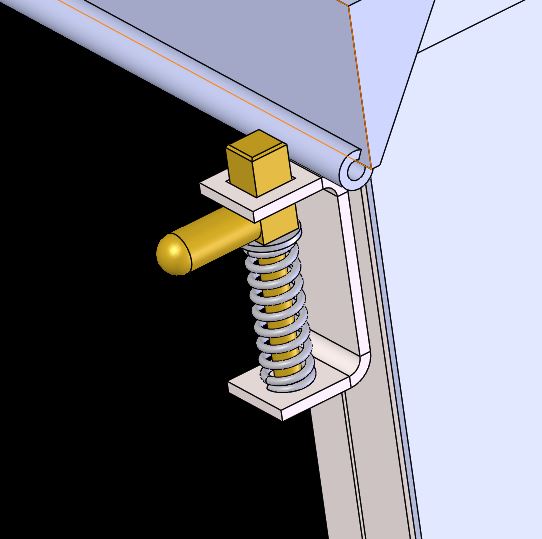

I am providing an update. Big thanks to Dick Morris , for the pictures he was able to provide thru his fellow member Pete, I have made the updates to my cad drawing to reflect this. basically a brass piece 1/4" square, and turned down to accept a spring and fit thru the alignment hole on the bottom.
It is very easy to see how this arraignment would have broken down over the years. the spring rusts and gets weak, then the brass part works loose and falls off, taking the spring with it. hopefully a stainless spring will help this as well.
as I had previously modeled this feature with out square hole I believe that on my sample was simply broken off.
Al Pomeroy
