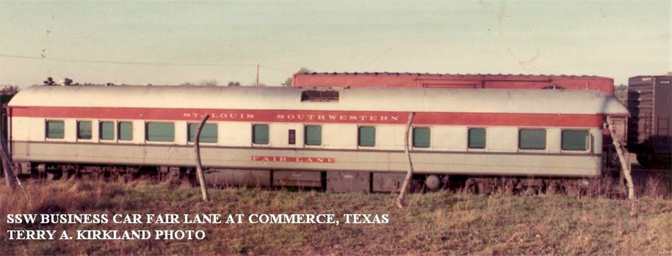

As for SSW/ Cotton Belt, the only passenger car (besides yours) I have seen photos of is the Fair Lane, a business car (that still exists at the Henry Ford Museum in Dearborn MI), below is a photo of it from the sixties. The font looks very similar to SP font.
SCANNED PHOTO 41 SSWFAIRLANE COMMERCE TAK2_Ed_Cooper.JPG [ 187.45 KiB | Viewed 10663 times ]

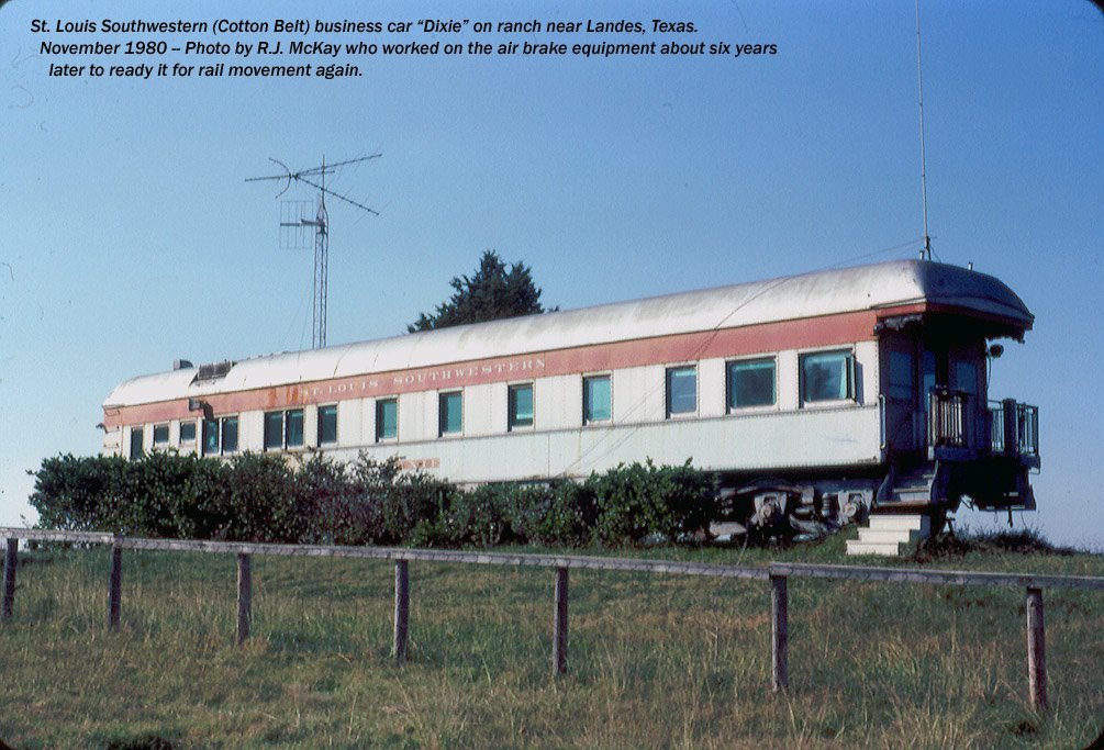

I was looking around and found a photo of your car SSW Dixie in 1980. Edit: and there are a half-dozen in-service photos of SP #127 Alamo here http://espee.railfan.net/sp-business-cars.html
