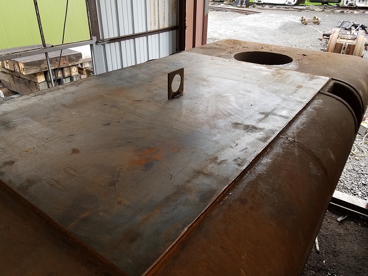

Every railroad needs a herald, even railroads that are currently 200 feet long. This is a modification of an older J&L steel logo.
The new cover plate for the saddle tank has been fabricated and placed on the tank for hole drilling. Amazingly Porter did not include any access holes into the tank so I cut a large opening in the top, framed it and made this cover. No problems with access now.

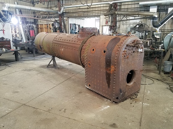

It has been quite a while since I have updated this thread, but I am sure that I have discussed the 58 on other threads.
At any rate, here is where we stand with the restoration.
The frame and running gear has been rebuilt. I am selectively replacing bushings and pins as money allows but generally the running gear is ready to be put back in service.
The rear platform, made up of several pieces of 2" and 4" steel plate, is being drilled and tapped for bolts to attach the plates to each other and to the rear of the frame. Originally that mass of weight was integral with the frame. I have made it removable.
The boiler repairs are nearing completion at JS Company. The major work included a partial front tube sheet, new smokebox bottom and reinforcing plate, one staybolt and new tubes. Generally we found that the boiler shell is so overbuilt that according to the NBIC we could lose 1/8" of shell thickness and still be thick enough for the full 200 psi boiler pressure. We do plan to run at a MAWP of 180 psi to stay in conformance with the Ohio historical boiler regulations.
I am hoping to get the boiler moved back to Youngstown sometime in mid to late February, mount it to the frame and start plumbing it back in with an expected first firing date as soon as the threat of freezing has passed, probably late March or early April.
When I come to the ATRRM conference in April it is my goal to have an operating steam locomotive to brag about!
