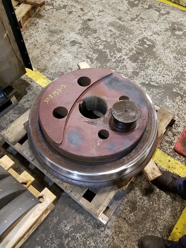

And then we have this. Counterweights that were so ineffective that they were probably put on for cosmetic reasons only. Solid steel driver centers, burned out of thick plate.
