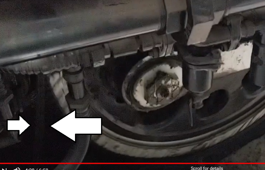

By the way, would anyone happen to know if DM&IR Yellowstone No. 227 at the Lake Superior Railroad Museum employs a similar set up to turn its drivers? I have tried to look up how the locomotive is set up, but have not been able to find clear photographs or videos on the topic...
This video sort of explains it, starting at 3:45, but doesn't show the connection between the motor and axle:
https://www.youtube.com/watch?v=Rhm_61ZMhNM

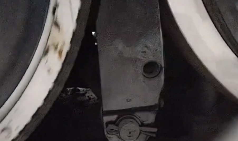

PostPosted: Tue Apr 06, 2021 7:17 am
Joined: Sat Feb 02, 2013 3:55 pm
Posts: 100
It would appear that they've got a sprocket that bolts to the outside of the tire, which a roller chain wraps around and is driven by the motor. You can see the detail in the screen capture that I have attached... Compare the left driver (with bolt on sprocket) to the right driver.
Additionally, in the other shot, you can see the roller chains in action. Very hard to tell with poor lighting, but in the video, it is easier to see the roller chain in action.
