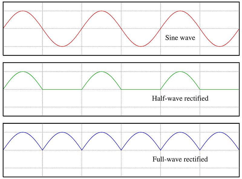

 Post subject: Re: Backyard Signals and Crossing Lights
PostPosted: Fri Jan 15, 2021 6:50 pm
Posts: 412
Rick,
Here is a picture that may help. The pulsating DC would be unfiltered:
mld
PostPosted: Fri Jan 15, 2021 7:50 pm
Posts: 2074
Perfect illustration. The tops and bottoms of the sine wave or AC could be considered +12V and -12V (not to be confused with ground) respectively. The line through the middle is 0V. You only want the +12. Hence the full or half wave rectifier. The filter smooths out the bumps by filling in the the missing parts so your line becomes flat at +12V DC.
