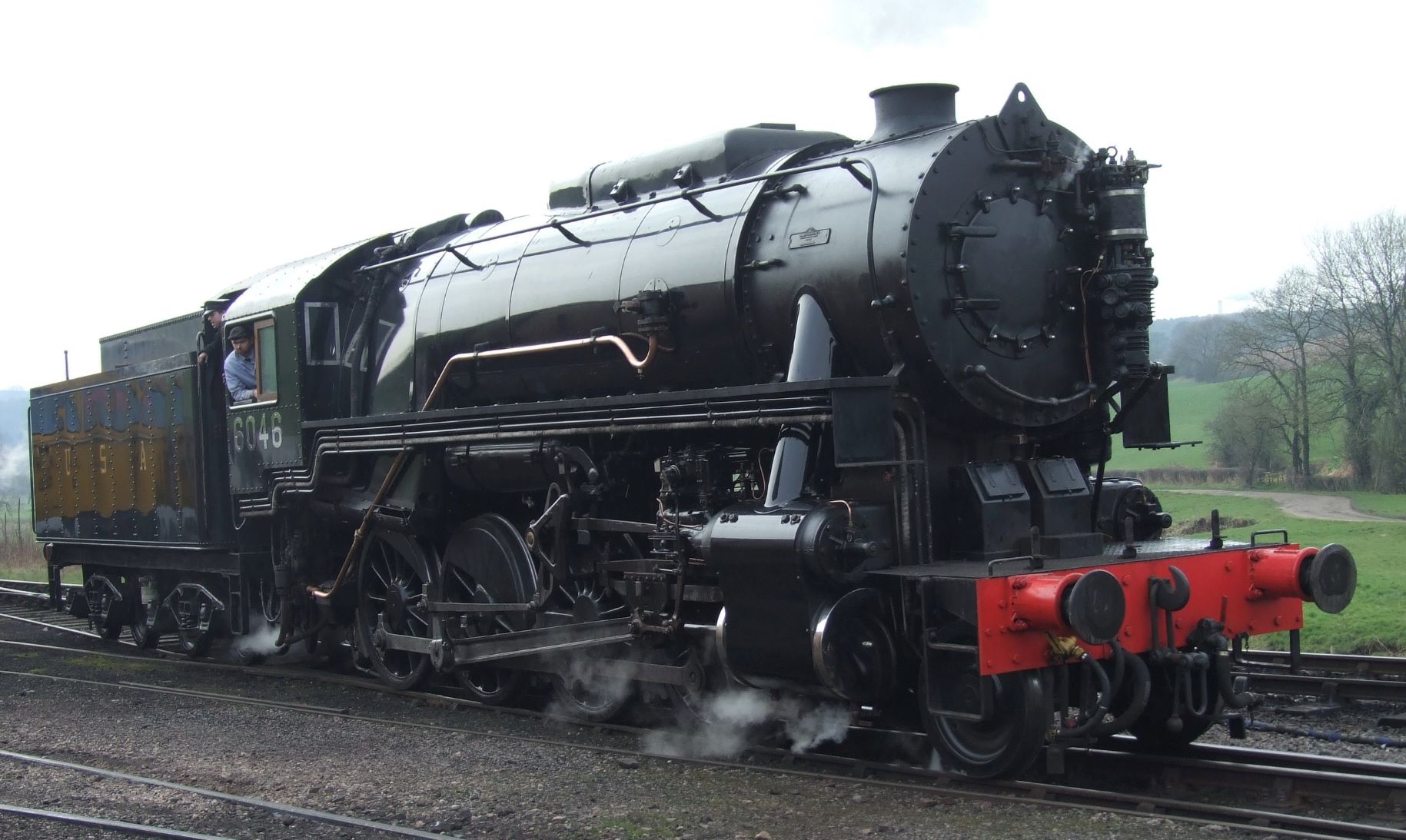

The preserved ones here seem to have an almost satin black finish on the smokebox...
Whether that was the case for the 1940's is another matter!

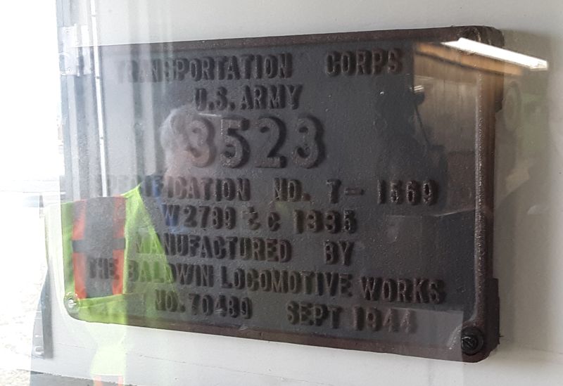

The original, rectangular Baldwin Locomotive Works builder’s plate from U.S. Army “G.I.” 2-8-0 #2630 (above) is made of cast iron, and was used to help make the aluminum replicas sold by the Age of Steam Roundhouse Museum. During World War II, metals such as bronze, brass and copper were in short supply but high in demand, and beginning in 1942 most new builder’s plates were being made from cast iron.
John B. Corns

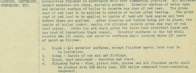

The image is from the BLW specifications for road numbers 2379 through 2382 built for the Alaska Railroad.
In the Bill of Materials for the order ARR 557 was built under, the paint is called out as 22 gals Camouflage Lusterless Black Enamel.

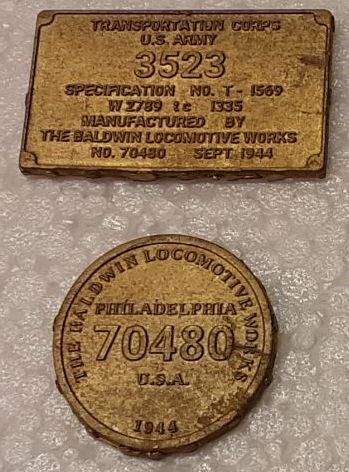

One correction to this post. By mid-1944 Baldwin was again using bronze in their builder's plates. I have the builders plate off Southern Pacific's #4293 and it is bronze.
Martin

Dick, thank you very much for posting that color listing. Finally I have written confirmation from the era that supports what I've always known; that Army steam locomotives were not painted OD green.
I have no idea why this has been something that will never go away. Model train companies love making them OD green and so many people have assumed that they were painted the same OD green that wheeled vehicles were. But period photo clearly support they were painted black!
The biggest eye-rolling situation for me is the Davenport 600MM gauge 2-6-2T at Fort Benning's Infantry Museum. It's painted in a badly-faded postwar OD green paint, the same stuff they painted everything else out back of the museum (even though the signs with period photos of those engines, right next to the loco, all show they were painted black):
But going back to this plate, I guess flat black it is. It won't be as 'cool' looking as bronze and black background, but it will be accurate and that's all that counts to me.
