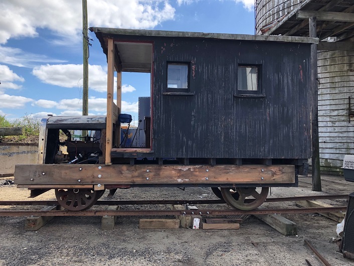

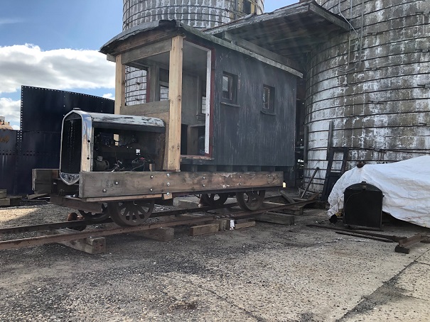

Posts: 728
Location: Wall, NJ
Thought an update might be of interest. Over the past few months we have focused on finishing up some motor work and body work. Some light rail has been set up for a short trial run in the coming weeks. It really shaped up nicely and we are quite happy with it. Once we are comfortable with its performance, we still plan to put it up for sale to help fund our PRR N6b cabin car project.
