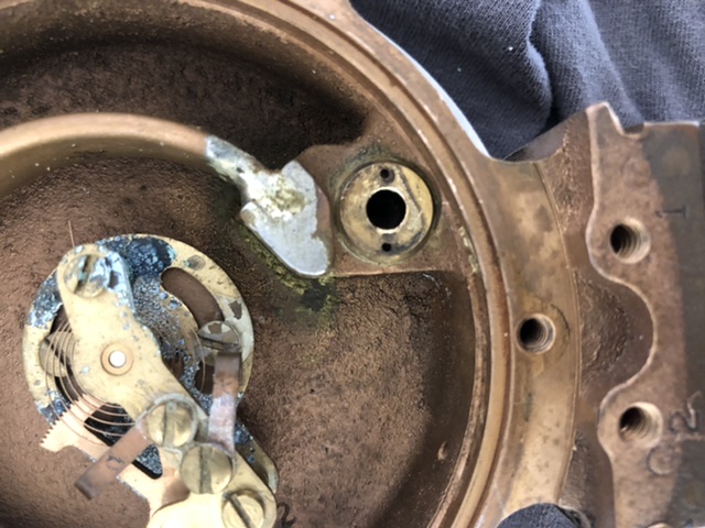

Thanks guys. Removed the unit and found that one of the orifices was partially blocked and the small gears inside the gauge had some gunk in it. Was able to free it up very carefully. But one of the rubber o rings inside was also cracked and broke when I attempted to remove it (see pic).
Eric, during your 92 day inspection, what reading should you get on the AFM gauge with the calibration dummy orifice hooked to the BP? I was going make my own tester with an old dummy coupling with a 7/32 hole drilled in it.
