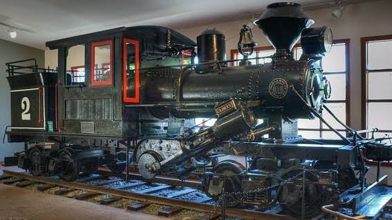

Here is how the remains of that engine look today in Duncan, BC.
https://bcforestdiscoverycentre.com/?page_id=656

A drawing of a 23-25 Ton Climax based upon John D. Lewis' notes and the Climax drawings of the 25 Ton Cab and Bunker/Cistern.
Very preliminary but it makes clear that the cab in the photo is an after market creation.

Posts: 1270
The cab, trucks, drive train and one cylinder are reproductions. The man who salvaged it wanted to get it running and he did.
