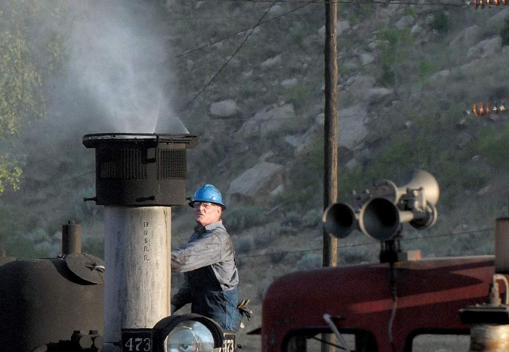

Having done some research since my last post on this thread concerning Japan National Railroad's rotary spark arrestor, I subsequently found out that D&SNG's current spark catching mechanism employs water jets to douse the sparks. This is a feature that is absent in the JNR system.
If anyone can enlighten me with the details of the D&SNG spark arrestor and its inner workings, it would help me to understand further the difference between it and the JNR system, and the consequent pros and cons of each spark arrestor.
Specifically, I am curious to see if the D&SNG's arrestor employs the same rotating fan concept. If not, a combination of the JNR rotating fan and D&S water spray may make for a more effective spark arresting mechanism, although presumably at the expense of impaired drafting and more cinders to clear inside the smokebox after each run, which seemed to be the case with JNR (some reports indicate 2.6 times more cinder buildup on a given run).
-Shogo
 Post subject: Re: Residents Sue D&S Over Fire
PostPosted: Tue Jun 09, 2020 4:07 pm
Posts: 2897
https://durangoherald.com/articles/40831#slide=0
Caption:"Steve Lewis/Durango Herald. John Harper of the Durango & SIlverton Narrow Gauge Railroad & Museum said spark arresters, which employ a screen and small water nozzles on the stacks of the steam engines, reduce the chances of hot cinders escaping and starting fires. Engine watchman Robin Schanbarger looks over a train returning to the station on Friday evening."
It would seem that D&SNG has thrown in the towel regarding coal-fired locomotives, what steam remains will likely be oil fired. I would have liked for them to experiment more with spark arresters from the late steam era such as the Japanese model you posted before, instead of such drastic changes as converting to oil (much less the purple and orange diesel I posted a photo of a few days back). But I lack the technical knowledge to be offering any advice on steam, free or otherwise.
