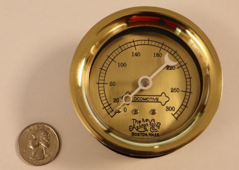

Having always loved the brass gauges of yesterday I knew I needed one for my locomotive so I made one and then others were interested so I started making a hand full of them for live steam locomotives. My photography skills don't do them much justice as they are such beautiful jewelry up close.
https://www.modelgauge.com/products
As far as making full size ones, you would use the modern movement behind the gauges, and the faces are easy enough to make all you need to do is come up with the artwork and send it out for etching. The harder part would be the bezel. I collect the full size ones and I can't seem to figure out how they formed the sheet metal on those bezels. If you ever get the chance pull the bezel off off of one and then there is a return bend on them that I just can't figure out what the tooling must have looked like to form one of those bezels. Anyone know how they were made?
I suppose you could turn one on a lathe you only needed one of them. Online metals sells 7" dia Brass in 1ft lengths for $1,189, so it may be better to make a pattern and have something cast up than to try to work with Bar stock. Anyone know where to get gauges with old school bezels on them?

As far as bezels the better gauges had cast brass ones that threaded onto the back. I have one and sold another built like that. These two also had cast brass cases not cast iron or stamped steel.
M. Nix
