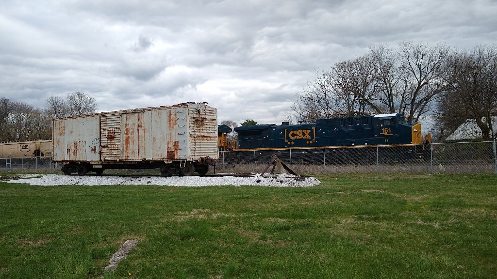

We unloaded it this afternoon.
Bill

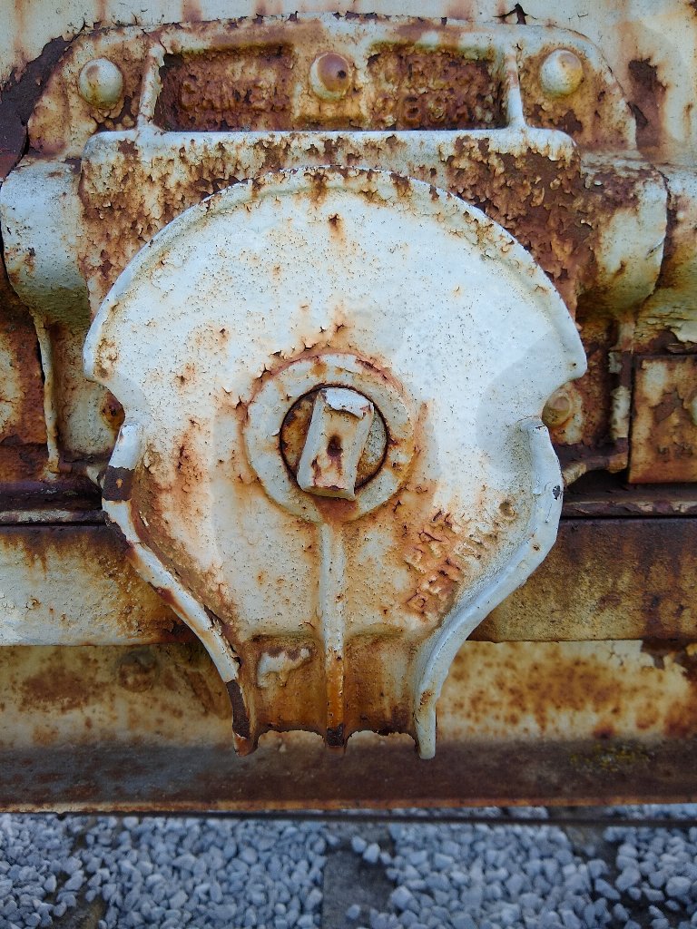

Oh,the doors are stiff but they do work. Anybody have mechanical info on the Youngstown doors and roller mechs? It also has cast iron wheels...
Here’s my experience:
If you’re really lucky, the trolleys are replacements and may have Alemite/Zerk fittings. Marine grease seems to work well and is somewhat waterproof. We have Zerks on some of our plug doors.
If they’re original and not worn badly, you may be able to flush them out with WD40 and squirt some lithium grease in there with a spray cans. They were usually made to be replaced so you might be able to take them off the door to work on them at the bench.
Make sure the tracks are clean and straight. That’ll bind up a door.
I haven’t replaced any trolleys/wheels yet but boxcar door parts are available and they could likely be a retrofit kind of thing that at least is close in appearance to what you have now. Freight Car America, Greenbriar, etc. and some smaller outfits. An online search may turn up trolleys you can use. Search for boxcar door parts or freight car parts.

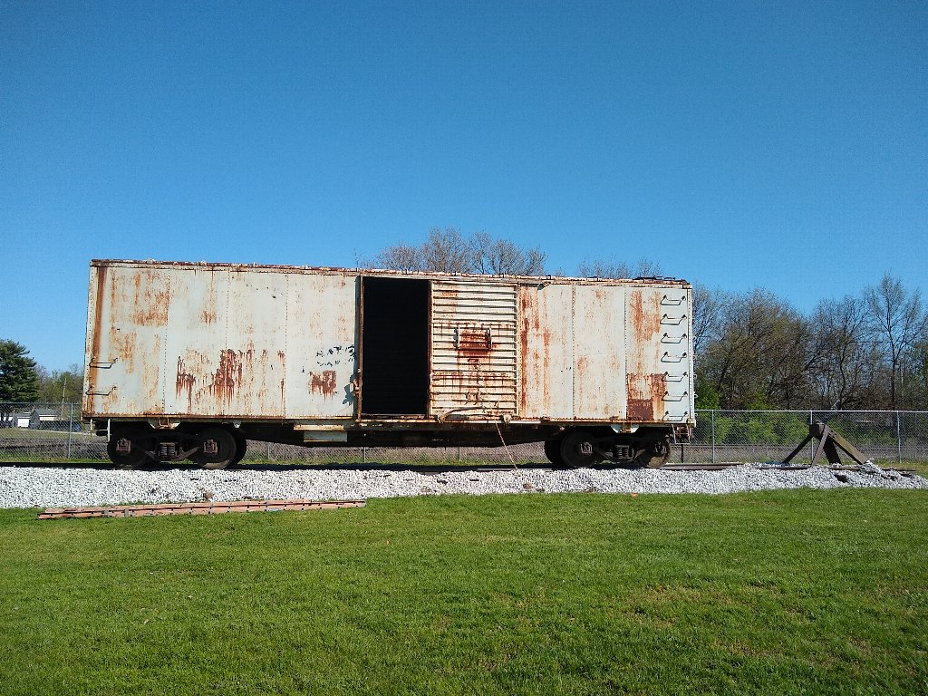

jayrod wrote:
Thanks Ed.
It looks like the zerks were probably there but removed.
