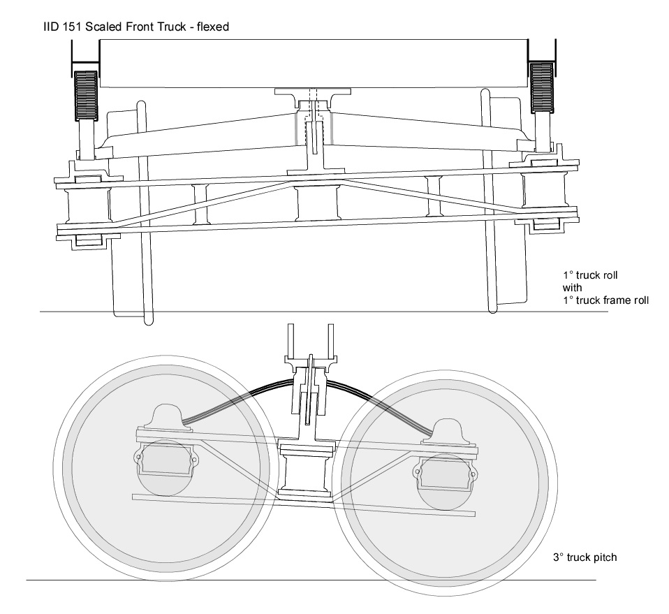

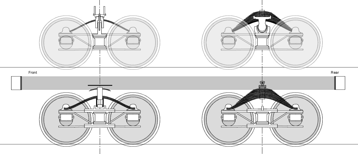

Based on Mr. Morris's dimensions and a little guestimation, I've updated the previous drawing to scale and added some detail. Shown here with 33" wheels at 44 1/4" centers at the tender centerline and the side sill. There is not enough shown in the pics to see the body bolster design beyond a twin plate similar to the side sills, so I left it as a simple beam for now. I took the rear truck pinned wedge from the CP229 drawing and added a grooved bearing plate simply on conjecture and for the front truck I added an actual center pin and stepped bore in the transverse beam. One point of design economy I came across - it appears the three centre columns in each arch bar assembly may be the same casting.
Perhaps the ball joint does not have the ball itself telescoping in a bore. Maybe, instead, the ball has its center point fixed by the containment of the socket top and bottom; and the telescoping occurs as a round pin passes through a cylindrical bore through the center of the ball vertically. The telescoping pin would accommodate the vertical movement while the rotation of the ball joint would accommodate the tilting of the bolster.
It could be, but I don't see it in the pics. The socket appears to me to have more or less vertical sides above a bottom hemisphere like I drew it above, and I still think that's a rubber covered ball or lined socket to reduce wear and impacts. If it were a captured/bored ball, the socket would likely be more closed at the top for capture and there would be no need for a rubber cushion if the ball were fixed in location for all three axis. I'd really like to take this tender apart and see it for what it is.
To give an idea of what the truck would do when skewed I put this together. Beam and spring groups are rolled 1 degree and the truck frame rolled another degree.
The larger bore in the beam is shown as 5/16" larger than the truck post and gives plenty of room to augment flex between beam and truck bolster. I don't believe this is necessary or desirable, but I included it to show what would result between beam and truck bolster laterally (but with no additional spring compression shown). If this loose fit was original condition, any wear would allow the beam ends to contact the side frame during severe impact/heavy spring compression under truck roll conditions. It would also contribute to Mr. Travis' 'narrow blade' syndrome, so combined with the rest of Mr. Travis's comments on increased wear and binding, I would think the fit would have to be fairly close, not looser. If both post and beam have the same thermal expansion, I would think the bore would only be 1/8" clearance at most and probably 3/32" or less. A looser fit between concentric cylinders is plain lost motion and makes for more/rapid wear and binding, not less. A piston loose in a cylinder will batter itself and the cylinder to death in relatively short order. The pitch/roll relationship between the beam and post/truck frame needs to be kept as close to zero as possible to keep the truck from self-destructing. A three degree pitch would be fairly extreme, but I used it to exaggerate the truck center column's relative motion.
