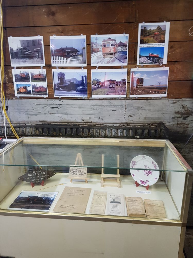

We don't display the originals, just printed ones since many of our pics are on slide, film negative, or smaller photographs. I scan them for the files, then print them off as required. I have a laminating machine and protect them that way. The pics that are used to describe what each piece of equipment is, are laminated in their display stand. they can get wet, with no damage. If by some chance they are damaged, they are easily replaced. Inside our display boxcars is much the same. The pictures are printed from the computer, and framed with simple, cheap frames that is basically just a sheet of glass with a backing. We use mirror clips to secure them to the wall to ensure they don't move, or fall when the car shakes. The attached pic shows what one of the displays looks like. I've changed it in the off season, and there's now more pictures, but they are all mounted the same.
