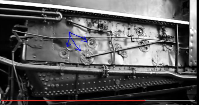

There are/were examples of removing all or some T-circulators, in some cases they were replaced with transverse arch tubes. I am unaware of locomotives having their syphons removed save few which were not originally equipped.
While circulators did pretty much just that.... circulate.... syphons (as lincolnpenn mentioned) increased a locomotives heating surface. Locomotives which were built with syphons had that heating surface included into the calculations for the boilers steaming capacity. Were one to remove OEM syphons from a locomotive it would leave a boiler less able to generate a sufficient amount of steam (or at the least increase the difficulty and stress associated in doing so).
Cheers, Jason
Stumbled on to this interesting view of No 2760's firebox side (youtube, m611martin). Looks like a combination of washout plugs for circulators (top row) and then some sort of drafting device (bottom row).
The C&O had 90 of these so were some built w circulators v syphons?

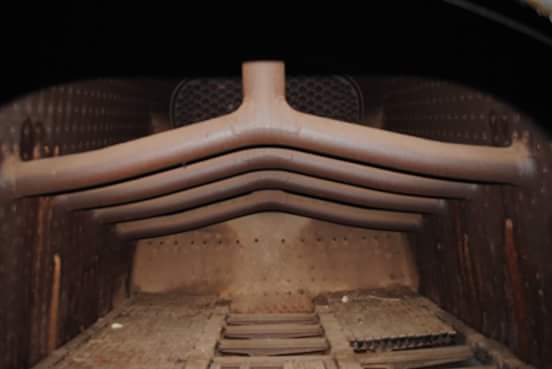

The original ALCO order (2700-2739) all originally had syphons. The Lima order (2740-2759) had circulators but I don't know about the last ALCO order.
Here's a look at 2756's firebox and circulator set up
