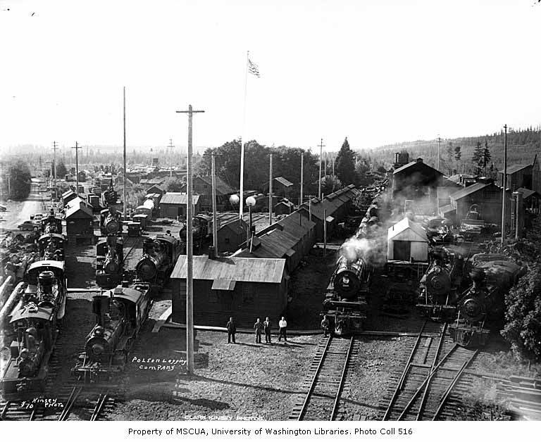

Here is a photo, could it be one of these at that late date? The caption where I found the photo reads: "This is a photo of the Polson Brothers Logging Co. out of Hoquiem, Wa. This pic was taken in 1940. The Line was started in the 1880's. The company was bought out in the 1950's by Rayonier Inc, who operated it until the the late 1960's."
 Post subject: Re: UP Steam Puzzle
PostPosted: Sat May 25, 2019 4:34 pm
Posts: 1270
I have always loved that photo and the #10 is probably there. It was scrapped in 1955. Almost everything in the caption is wrong.
