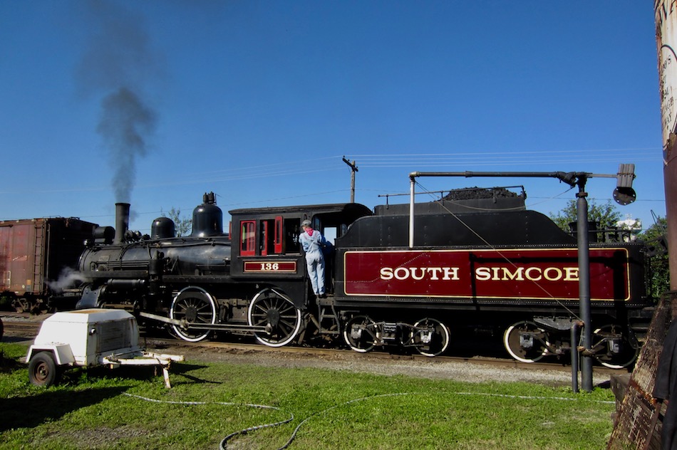

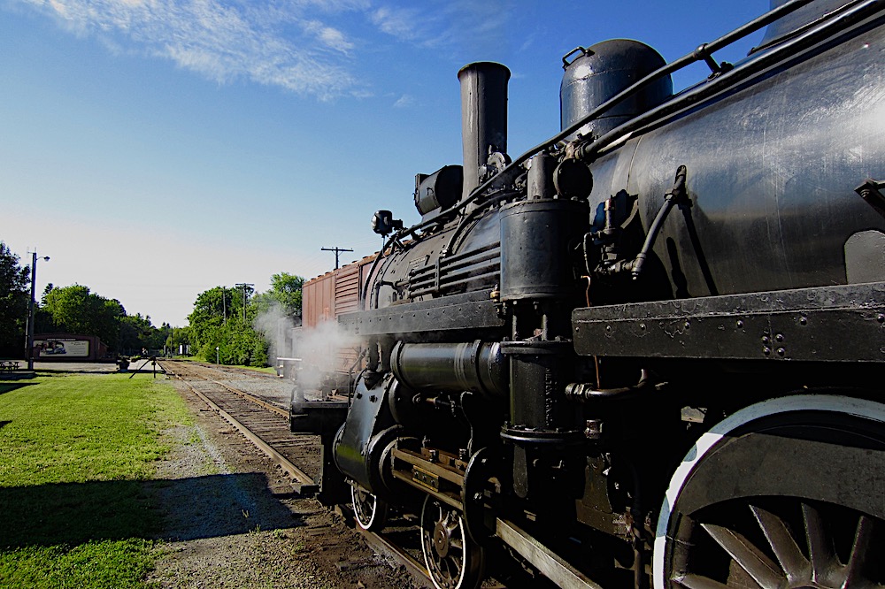

Great thread. Have learned a great deal about air pumps. Looked at your latest rendering, which shows a non-finned version. I guess that is what's fitted to CPR 136..? A 4-4-0 1883 Roger's, now running on South Simcoe Railway at Tottenham, Ontario.

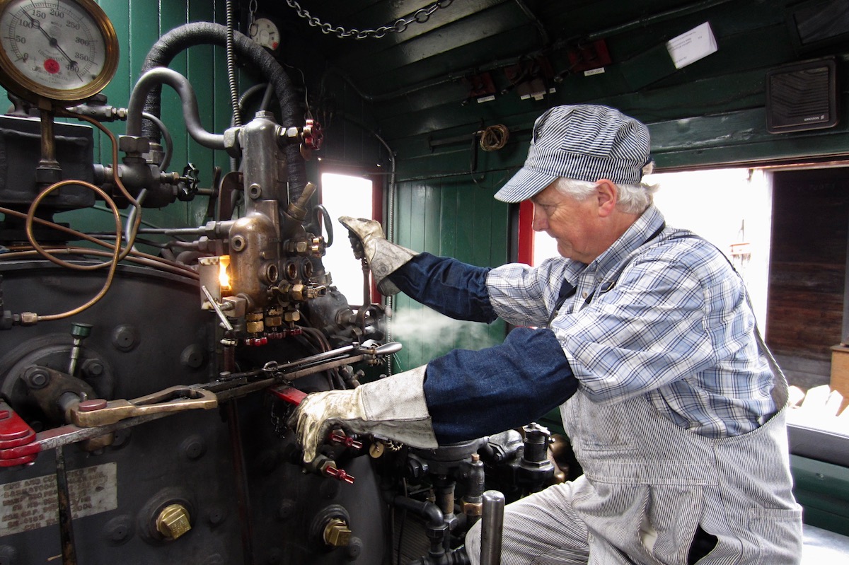

Here's a quiz question...Anyone care to comment on what Hogger Bryan is up to..just before departure...?
Trying to find 25 lbs. more steam?
 Post subject: Re: Westinghouse 8" Steam Air Compressor
PostPosted: Tue Apr 23, 2019 7:06 pm
Posts: 172
re. 160 psi.. not showing on the gauge.
Nice answer..smiled at that.
Retired CN railroader Bryan is bringing #3 to operational condition.
Seen here, simmering quietly, waiting for the crew to arrive.
After the hostler brought it out of the shed.
Bryan is topping-up the boiler water using the injector.
Adding that cold water will cool things down.
Thus the low boiler pressure.
But didn't take long to build up full pressure.

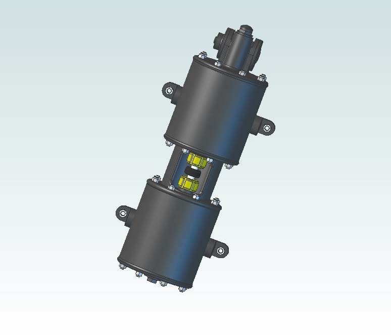

Looks like I am going to have to change the color of the shaft compression fittings (from polished metal to brass) and their appearance for which I used pictures of a 9 1/2" or 11 1/2".
The spacing of the bolt holes on the 8" "match" the mounting studs on the Climax F136 mounting bracket given Climax's manufacturing standards. I measured 20 1/4" and the drawing I found states 20 1/16".
They found wood cylinder lagging in Climax 1551 when it was dis-assembled for restoration. The photos of the Westinghouse Air Compressors makes me think that the wood lagging was original.
PostPosted: Wed Apr 24, 2019 7:50 pm
Joined: Wed Dec 02, 2015 10:38 am
Posts: 172
Location: Vienna, VA
A WABCO 8in Compressor with brass compression fittings. A 3D pdf may be downloaded at this address:
