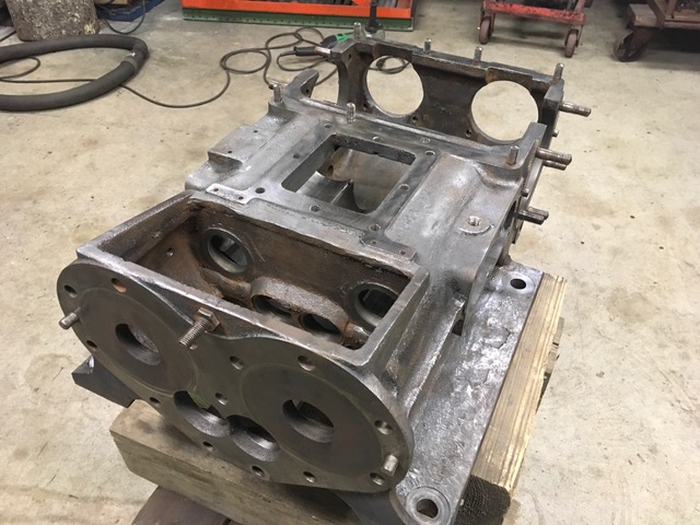

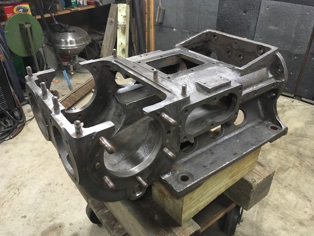

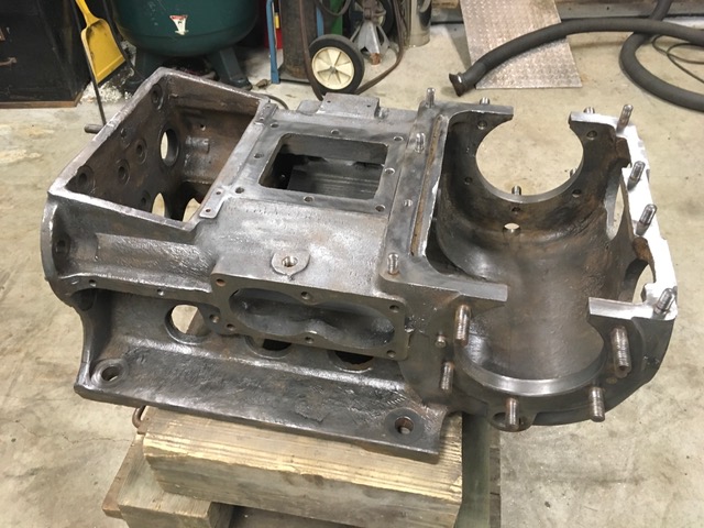

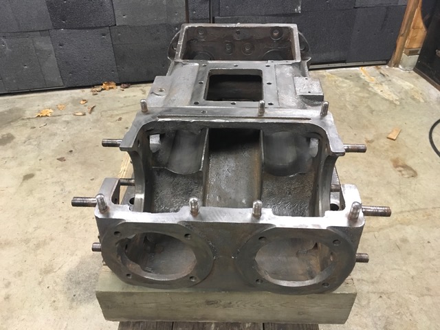

Thought you guys might like to see some pics of a Standard Stoker Co. 5"x5" bare engine bed stripped and clean. A bunch of hours since the first pics in this post!
Bob
