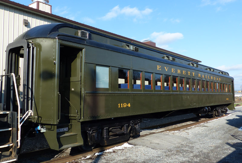

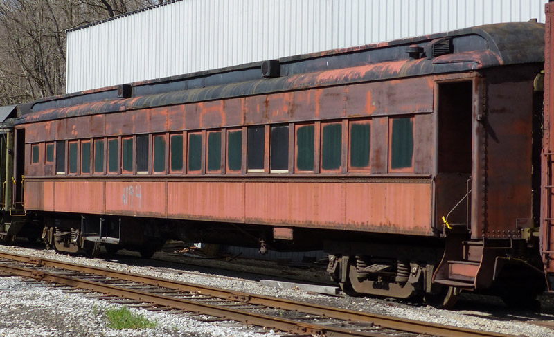

The Everett Railroad has completed restoration of former Central Railroad of New Jersey coach 1194. The project took place at the company’s Duncansville, PA, shop over the course of two and a half years. The 1194 was acquired from Jerry Jo Jacobson in 2008. Repairs were made under the supervision of Jason Lamb, general manager, and Mike Fink, shop supervisor.

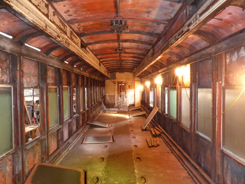

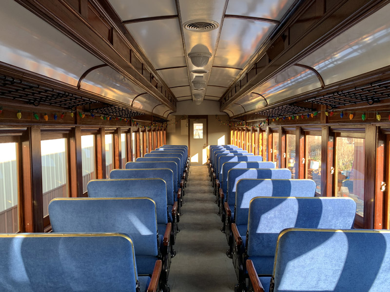

Work included complete replacement of the lower 6” of the roof, fabricating and welding new window sills, window post covers, drip edge, ventilators, steps, traps and doors. Several sections of floor had to be completely replaced including steel substrate. Interior inlaid mahogany was salvaged, stripped, repaired and varnished where possible and supplemented with new mahogany millwork. New oak tongue and groove paneling was custom milled and installed below the window line following the installation of new backer boards and brackets. All window sash is shop made new, with hardware supplied by the Strasburg Rail Road. Seat frames were salvaged from other cars, sandblasted and painted. All seats were repaired as necessary and received new upholstery. Following the example of the Valley Railroad at Essex, CT, ceiling panels are formed from aluminum sheet.
The car was completely rewired and is equipped with LED lighting and speakers for the PA system. Ceiling ductwork was reinstalled to facilitate air conditioning if desired at a future date. The 1194 remains steam heated but the interior pipe runs were scrapped and replaced with new style fin-type baseboard radiators. UC brake equipment was removed and the brakes converted to freight-type valves. Trucks were removed, cleaned, inspected and all worn components repaired or replaced.
Sandblast and prime was done at Curry Rail Service. Following additional body work in our shop, the 1194 was painted and lettered by Jeff Connor of Railcar & Military Equipment Painting.
The principle remaining work is to finish installation of the restroom facilities.
Coach 1194 was built in 1927 by the Bethlehem Shipbuilding Corporation's Harlan plant in Wilmington, DE. It was one of 267 standard clerestory roof commuter coaches acquired by the Central Railroad of New Jersey between the years 1922 and 1927. As built the car had a capacity for 72 people and was finished with a mahogany interior. Sometime in the 1950's the 1194's coach seats were removed and it was converted to a commuter club car, named "Jersey Shore", and fitted with lounge seats and equipped with sealed windows and air conditioning. The Everett Railroad owns five additional CNJ cars and the experienced gained on this project will prove invaluable on future restorations.
