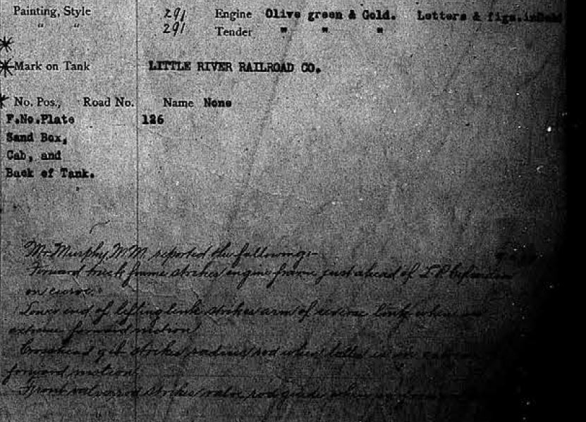

Last but not least, the Baldwin Spec sheets on file at the DeGolyer library list the paint scheme as Olive green with gold lettering. The copy of the microfilm is enclosed along with some remarks apparently by the Little River master mechanic regarding the locomotive, which I find difficult to read, but someone here may be able to decipher.
I lightened it and cleaned it up a bit, didn't help too much. A higher res scan would help. A couple of words are pretty tough. What I can get out of it is this:
"Mr Murphy, MM. reported the following -
Forward truck frame strikes engine frame just ahead of L.P. Cylinder on curve.
Lower end of lifting link strikes arm of (radius) link when in extreme forward motion.
Crosshead gib strikes radius rod when _____ in ___ (extreme) forward motion.
Front valve rod strikes valve rod guide when in forward (motion)."

You got more of it than I did. Unfortunately, the scan is what you get from the DeGolyer collection as it was done more than 30 years ago, but it was saved, and it is out there for us to glean data from.
