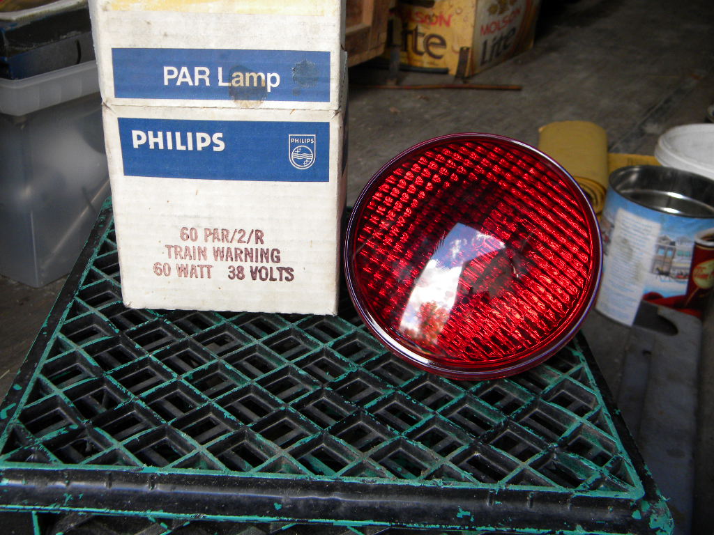

Hi,
I have the following which i beleive, could be what you are looking for. Let me know.
Len
