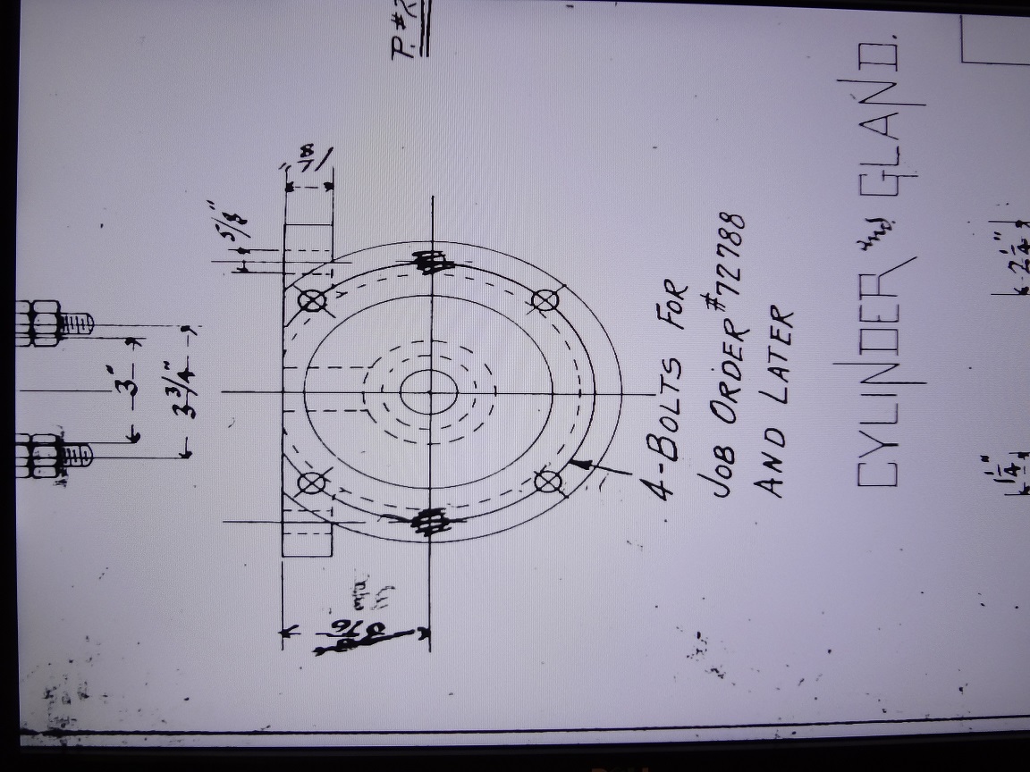

Sounds crazy but, I'd like to put brakes on a locomotive that will likely never run.

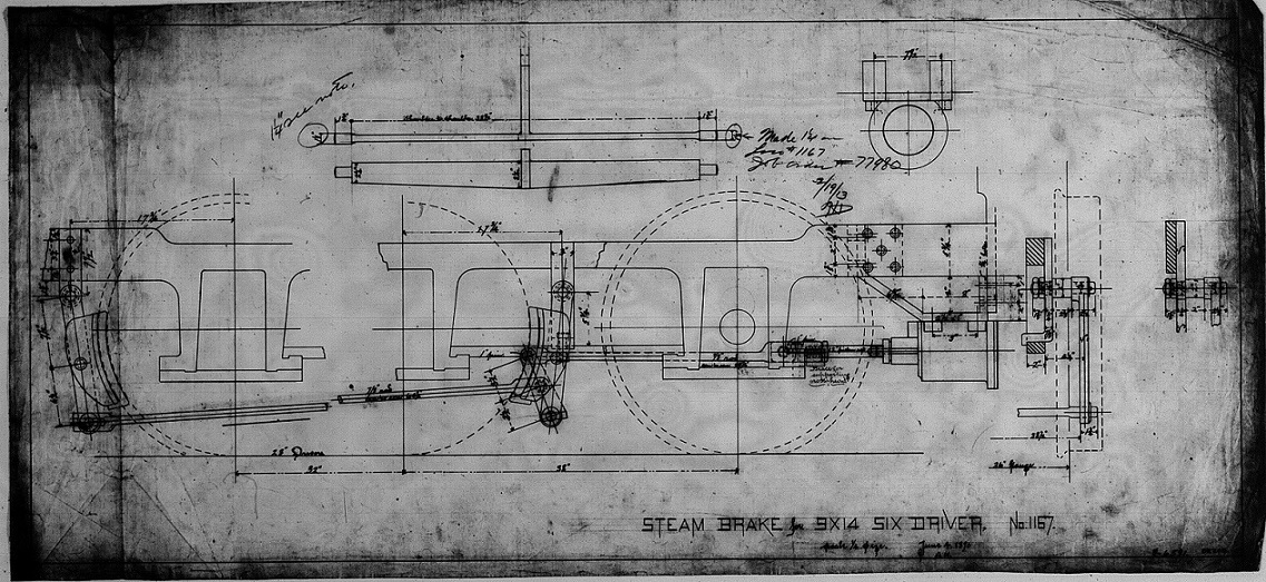

About a year ago, I acquired a 36 inch gauge 0-6-0 locomotive, built in 1890 by H. K. Porter as a street motor or steam dummy, CN 1167.
It originally had steam brakes but, the cylinder is missing.
File comment: Original Brake Rigging

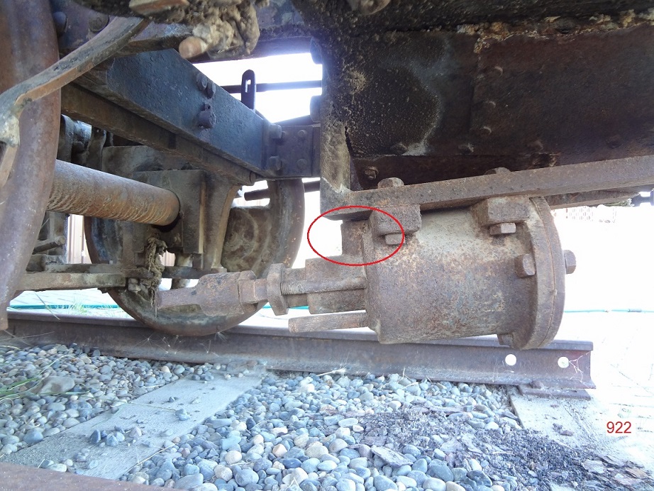

The cylinder is very similar to that on CN 922 shown below.

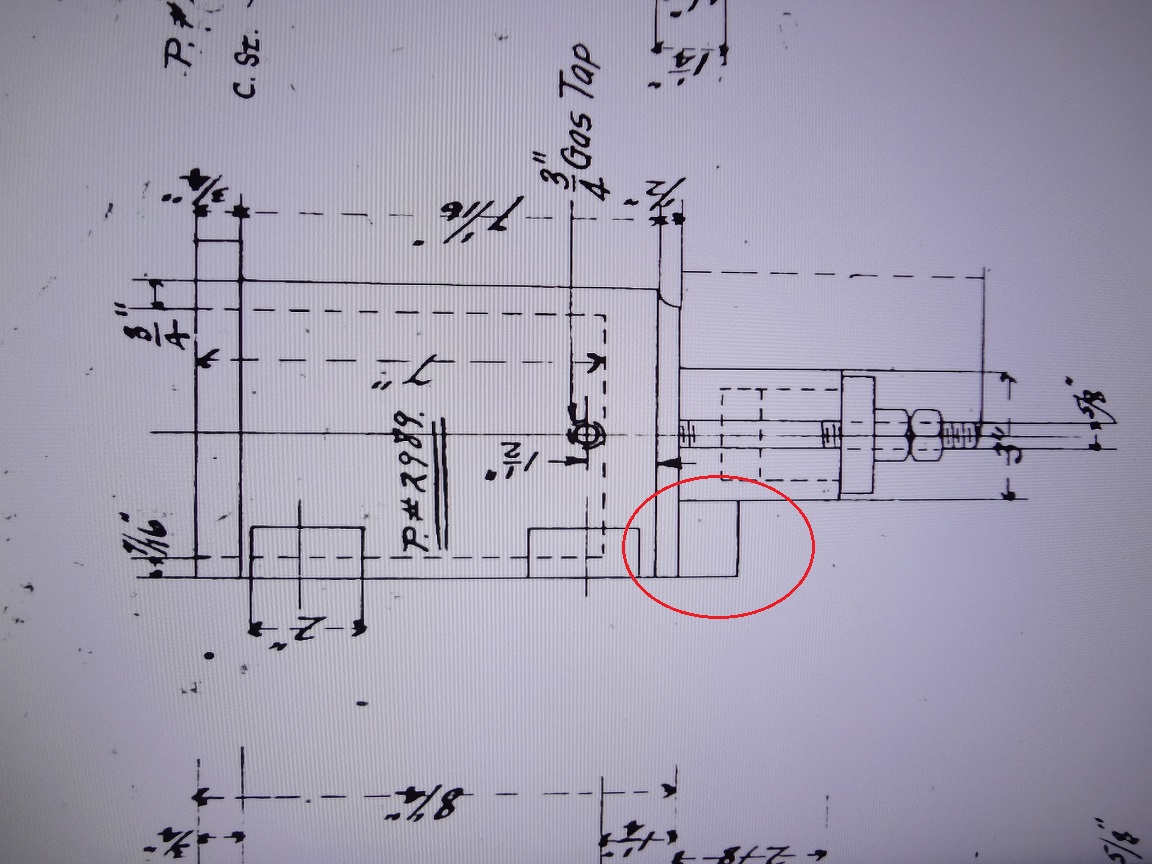

I regret not closely examining the feature circled in red below, when I had the chance.

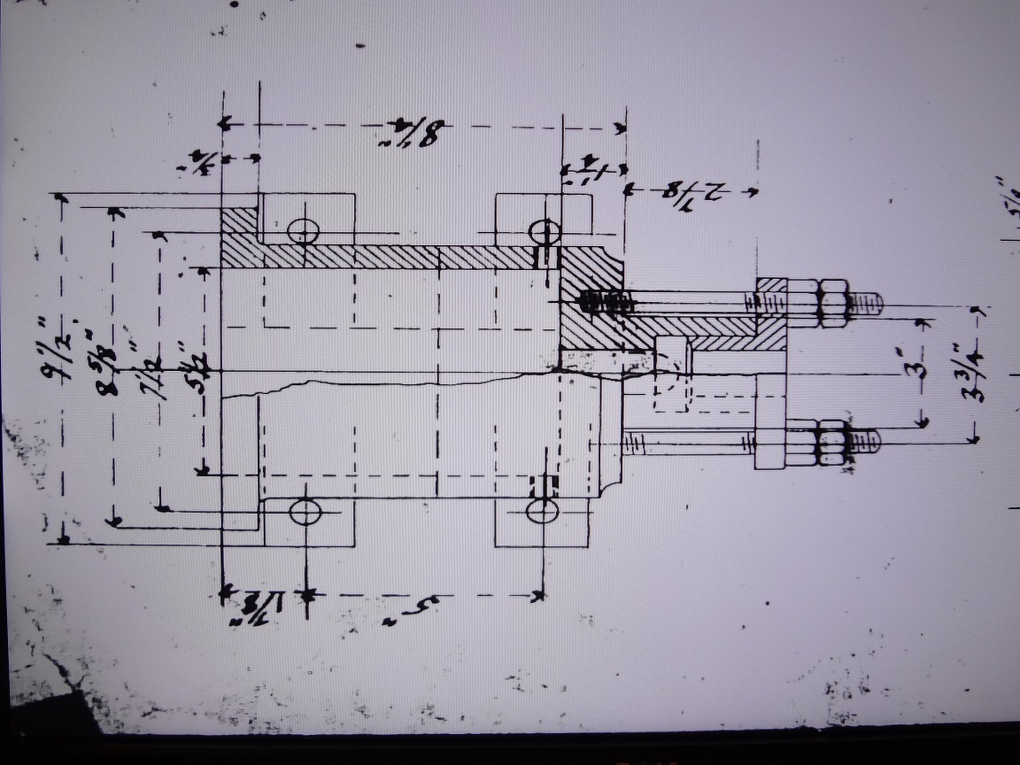

However, based on the Porter drawings, it appears to be just a support.
Anyway, the cylinder seems simple enough to replicate.

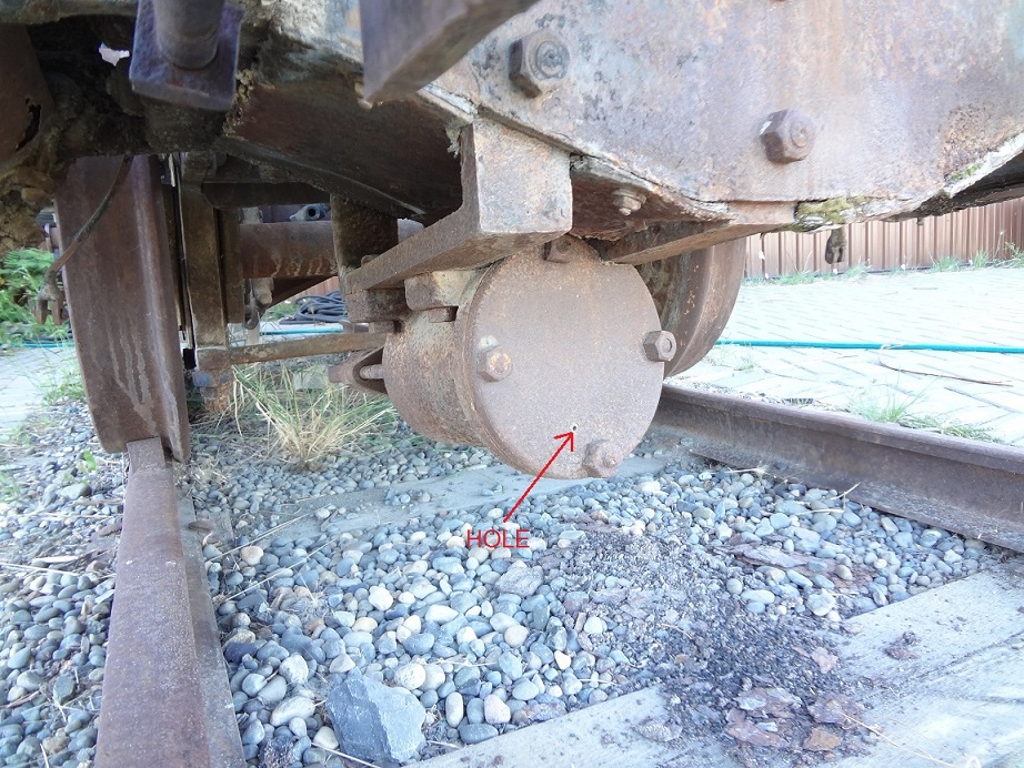

CN 922 has a single steam line connection and small vent hole in the cylinder head.
There was no return spring so, any pressure was released either at the brake valve or through a cylinder drip valve, when the steam was cut off.
Does my theory about the support and steam connections make sense?
I'd like to hear about any similar setups.
File comment: CN 922 Cylinder
File comment: Porter Drawing
Thanks,
Dave

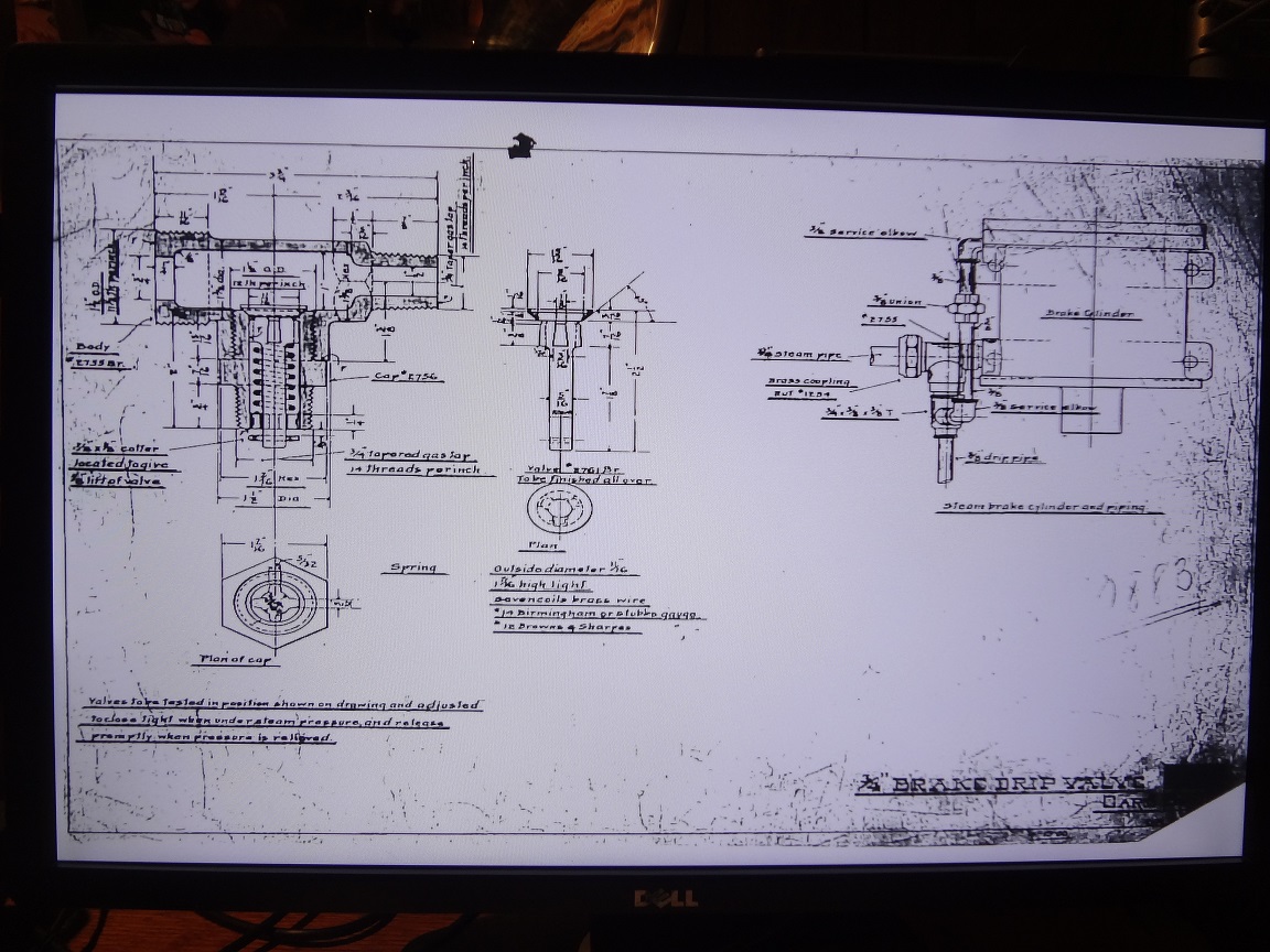

I've worked on some small lokies with steam jams - the majority do not have the steam pipe on the end with the packing gland - in fact, don't have a packing gland at all, because the steam goes in and out of the other end. Some don't even have a head on the steam side.... anyhow, what's important in your pictures is the slope down from the bore to the steam line in / out. At the lowest point is the condensation relief valve which is a poppet valve like a snifter but held up from its seat by a spring with very little spring rate on it. Steam entering the line to the cylinder close it against it's seat. Steam having been removed by means of the 3 way steam brake valve in the cab the lack of pressure in the cylinder / line allows the spring to lift it off its seat and gravity drains the condensation - vacuum is broken through the valve being open to the exhaust / outside air. Somewhere I think I have the Glover Machine Works drawings for this stuff...….

Looks to me like the cylinder is in fact a single acting 'pull' type with packing gland. The rigging drawing confirms it's a pull type with the (looks like 5.5" x 5.5") dead lever arrangement on the rear brake beam. Do you have a drawing of the cylinder head? It would tell if there was provision for a spring return, even if 922 didn't have one. An older, small, inexpensive, very-low-tech switch engine might not have much of a return system since banging around would loosen things up fairly quickly and they weren't operating at high speed. The small hole in the head would be the air exhaust for applying the brakes - its small size would function as an orifice to limit the speed the piston can move to avoid hammering the brakes. The boss you circled looks like it's intended to be bored as an oil cup or lubricator line fitting for the piston. Might have been a customer option since there isn't any boring/finishing drawn on the prints. It's a pretty crappy location for a cup, being right in front of the ash pan. A better solution was probably steam oil in the brake steam supply - maybe a small single displacement lubricator if the customer wanted to splurge.

The release on the little lokies is from the weight of the shoes dropping themselves away from the treads. I think the hole in the head in your picture is to prevent back pressure or vacuum on the "wrong" end of the piston space in the cylinder. The boss at the low corner could be for the steam line or a separate condensation drain valve.

Here's a slightly different or vertical setup with a drip valve.
I'm guessing this is single action, with piping from head to drain condensate.

Local museum has a Vulcan locomotive with a single acting steam brake cylinder.
It's about the same size but slightly different configuration. Original piping is missing.
The Porter drawings show many configurations of brake cylinders, including air, vacuum and steam, single and double action.
