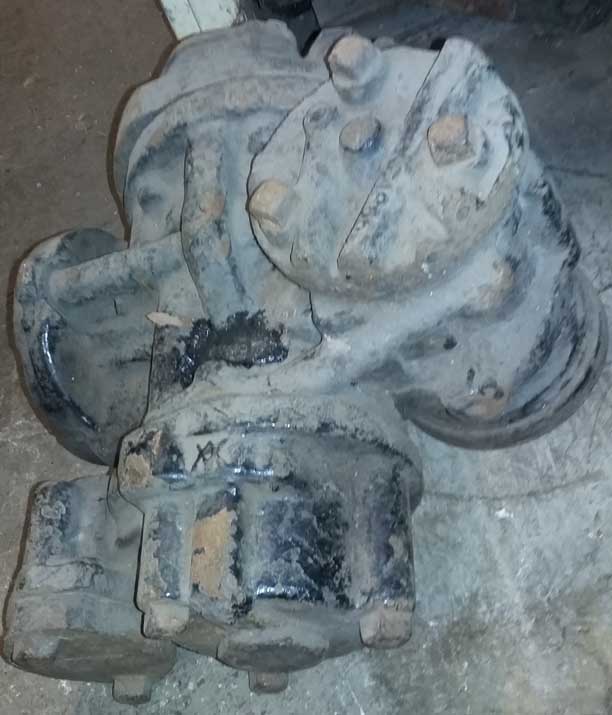

I have a mystery valve portion. The body has a casting number "9297" and that's a!l I know about it. I know it's not M23 or 6. I suspect it's a passenger car valve though. Any ideas?

Location: Northern California
Can you post a picture of it?

Dave,
 Post subject: Re: L and U triple valves
PostPosted: Wed Jun 13, 2018 5:00 pm
Posts: 529
That picture would be of a UC valve service portion.
