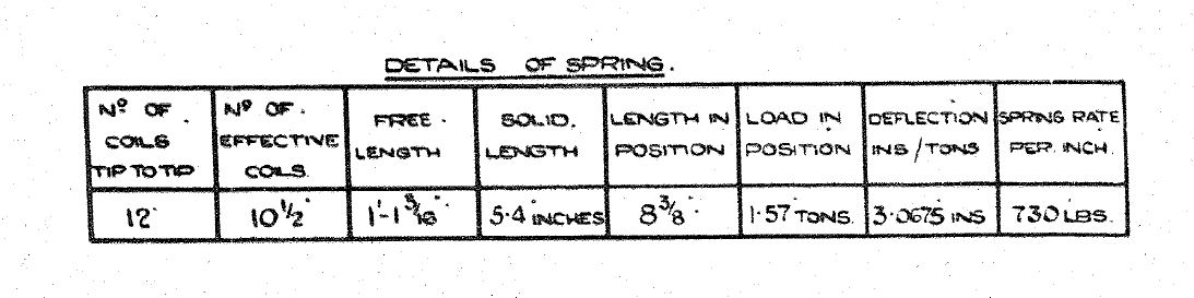

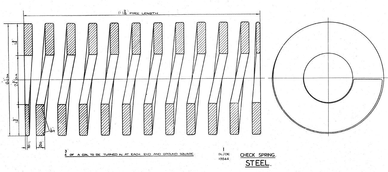

In order to meet railway certification rules, we need to keep as close to the original drawings as possible. We are very lucky as most drawings are available for copy at the National Railway Museum in York, UK. The front 2 axle bogie has rectangular section coil springs for lateral control which are proving very difficult to source. These have a 6 inch outer diameter and most similar die springs, available commercially, go up to a maximum outer diameter of around 2.5 inch.

File comment: Spring specification on drawing

File comment: Rectangular section coil springs
