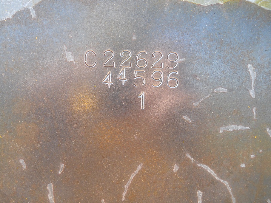

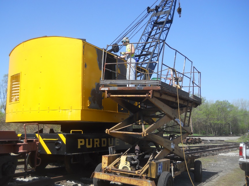

Les Beckman wrote:
Mark points out that it appears that the original Orton paint may even have come off.
Since the weather seems to have turned for the better, Mark has been working on the Purdue crane and I thought I would post an update. The first shot below, shows Mark using an air compressor to remove any loose paint/primer that is still on the bad side of the crane. Mark also discovered that since the original Orton paint and primer came off this past winter, a number of codes impressed into various steel panels have been exposed. A close up of one of the panels is shown in the second shot. Note the Orton builders number 44596. Finally, a shot taken at the end of the day showing the primer that was applied. Yellow finish coat coming up!

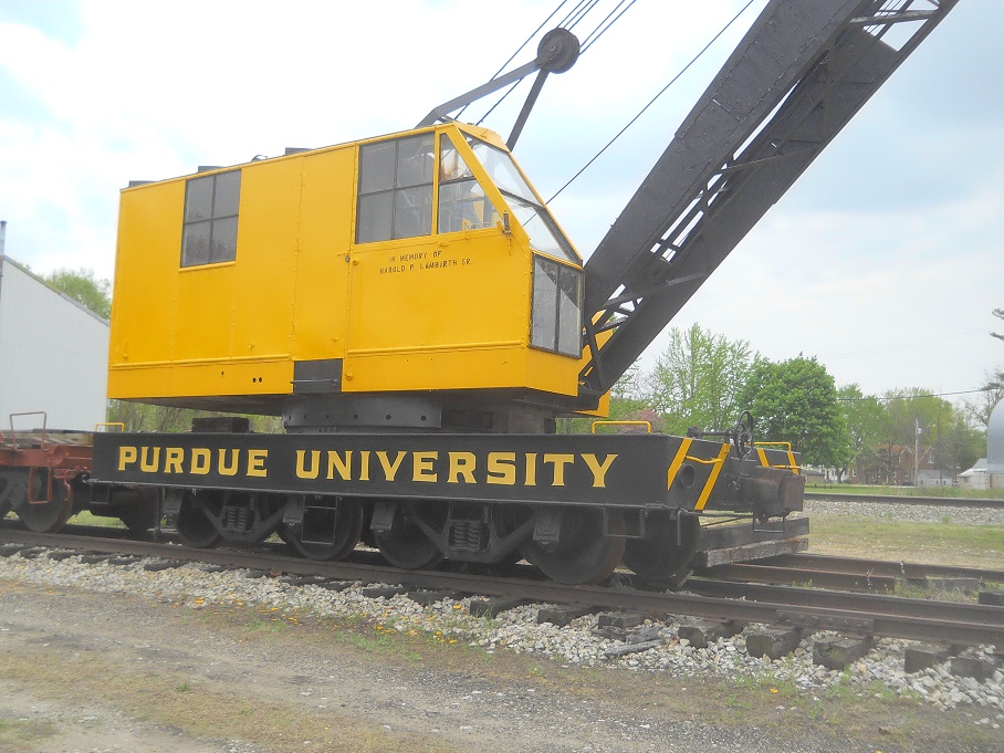

Mark put the finishing coat on the Purdue crane this week!
