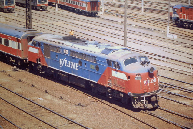

Don't forget various off shoots of the bulldog nose was used for overseas locomotives, and often on double ended units such as the Victorian Railways B class in Australia and the very similar DSB Class MY and similar types in Europe.
Bob
V-Line A class diesel (A62) in the yards at Spencer Street Station, Melbourne (now called Southern Cross Terminal), in November 2003.
One was in use on the branch service from Frankston to Stony Point when I went back there in April 2004.
Not sure if any of these are still in passenger service, but I believe they were up to about 5-6 years ago....

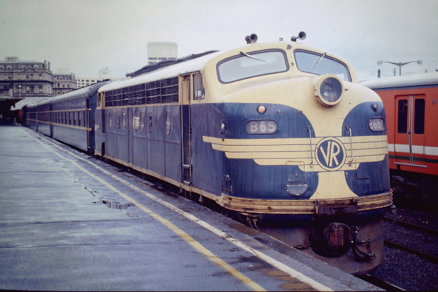

11 Years earlier, this B class certainly looked if it had escaped from the Erie......
