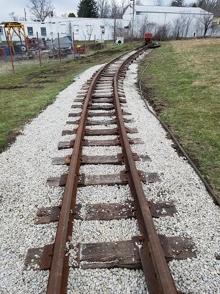

File comment: I would like to use 100RB rail as much as possible with 85 ASCE turnouts. Those two rail sizes are fairly close in size and making comp joints is rather straightforward by shaving a little off of the 100RB bars. We also use full sized ties cut in half.

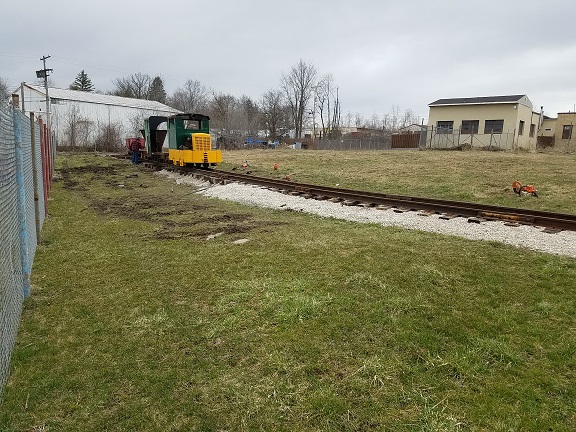

File comment: Track construction is proceeding northward to the north end of the property. Just behind the Brookville a turnout will be installed to bring a track into the area in the foreground where it will split into two tracks. Those tracks will run behind the Tod Engine Building and be used for storage of rolling stock.

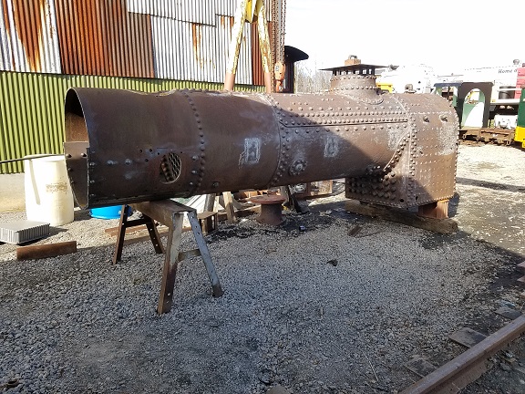

File comment: J&L 58's boiler is now back on the property. It got a partial front tube sheet, new tubes and the bottom half of the smokebox replaced. I'm now finishing up on some work including lapping in the throttle, replacing some studs and a sandblast and paint.

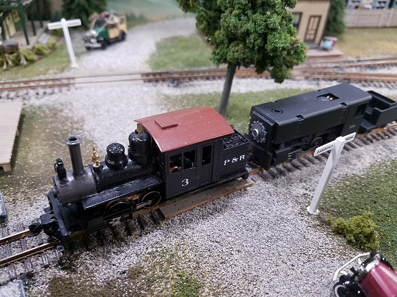

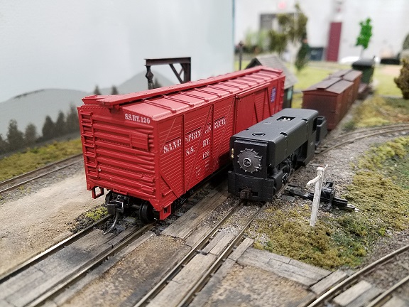

File comment: I attended the Midwest Narrow Gauge Shows a couple of weeks ago and had the first chance to run our scratchbuilt HON30 model of the 58. Also had the chance to pose it next to this Maine Forney as well as a standard gauge boxcar. In real life 58 weighs approximately twice as much as the Forney or the 40' boxcar.

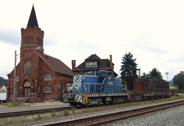

A very interesting and worthwhile project, particularly its coverage of the use of rail transport normally "out of the Public view". I particularly like the HOn30 version as well!
At least I know what these cars (Ingot cars) are that I protographed on a standard gauge "inter-plant" steelworks line in Natrona Heights, PA, a few years back are now - Though the line in this case runs alongside a public street, so you can at least observe the traffic.
