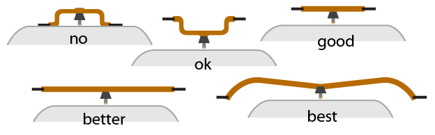

You know those U-hangers that put the crosswires at the same height as the trolley wire? You don't use those with pans, they will strike. You either flip them over (inverting their benefit and making the hanger prone to rocking), or use flat bars with less trouble, or ideally wider versions of same.

With switches and diamonds, you use a trolley frog that is correctly ramped for pans instead of one that is not, or an extra wire that carries pans under the frogworks as you would for a section insulator... or on rarely used non-revenue track, you just put out a bulletin order saying "no frog, expect to dewire". Any trolley operator worth his salt will be watching for that anyway, if he knows he's in little-poled track.
You can even do trolley bus (although San Francisco does not), you just shove the return wire a couple feet over. Now the bus can't swerve quite as far left (but would rarely need to since LRV track is usually in the inner lanes) -- and will be prone to losing one pole before the other since the poles are no longer parallel. Modern battery buses and powercatchers which yank both poles down on any dewirement make this a non-issue.
