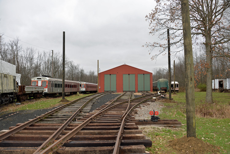

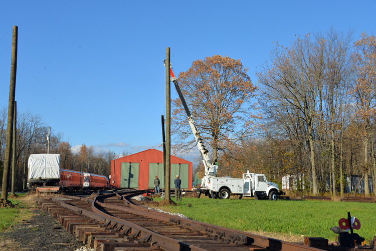

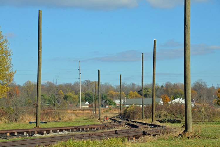

Early this year, the Northern Ohio Railway Museum ran a very successful fundraiser called Yard Renewal and Electrification. The goals of the project were to rebuild all the track pictured and electrify it. To date, culvert work to address drainage issues has been completed. Both curved sections of track and 5 switches have been rebuilt with new ties. Ballasting and surfacing of this trackage is still to happen. We are continuing outdoor work including grounds and track work at the Museum until Mother Nature forces us into retreat.
For the last couple of days the overhead department has been working with a local contractor to set 29 new poles along the track that is a part of this project. As this is written 21 poles have been set and the contractor is returning Thursday to finish setting the last 8 poles. In the spring the overhead department will begin installing ground anchors in appropriate locations. Also span wire and bracket arms will be put up. Then finally the wire.
The yard renewal and electrification project was funded with a matching grant from the 20th Century Electric Railway Foundation and donations from our members and the community. Thanks to the foundation and all our donors that made this project and Pole Season possible.

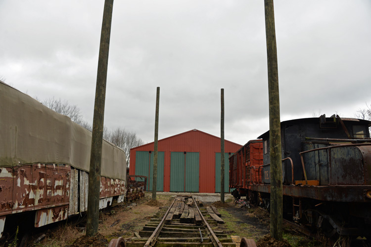

File comment: View looking south from the Bennett Carhouse. There are 4 more poles to go in this area from about where the picture is taken. one pole can bee seen on the lower right hand corner.
File comment: Pole being set in front of the Bennett Carhouse.
File comment: Main track is in the foreground with the carbarn lead in the background.

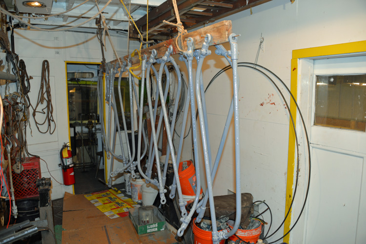

At present overhead components are being gathered and prepared. Attached is a picture of some of this activity. Pull off arms are being rehabbed. Our wire will be strung to be compatible with both trolley poles and pantographs. We have cars that use both technologies. We also build our bracket arms on the ground and then attach them to the poles ready to add a trolley ear and then wire. So we have plenty to do on the ground in prep for aerial work.

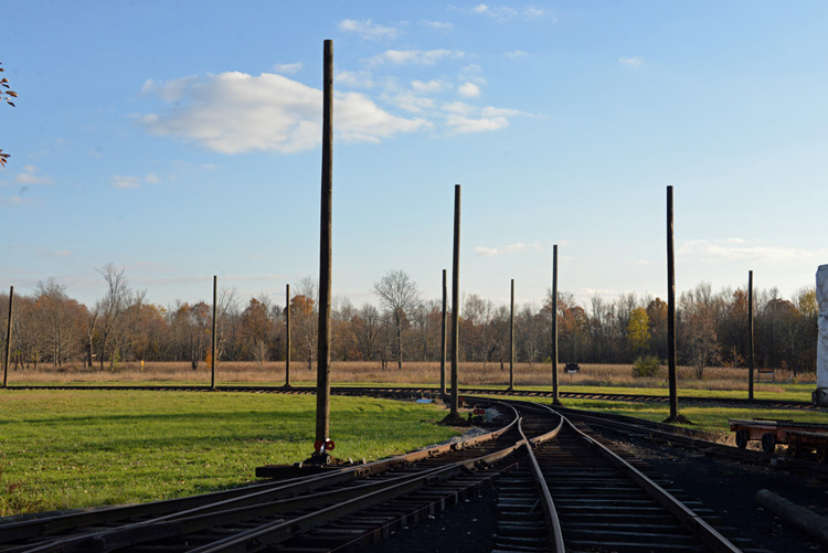

File comment: New poles in front of the Bennett Carhouse. Trolley wire will be hung from span wire between matching poles.
File comment: New poles in back of the Bennett Carhouse. This is where the overhead passing through the carhouse will terminate.
File comment: These are pull off arms that will go on our curved sections of wire. Photo taken inside line car 024 which is also doubling as a paint drying booth.

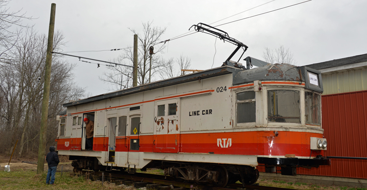

What is the status of 024? Operational where wire is available?

Car 024 is operational and has run off the overhead. It has also operated off an "extension cord" that plugs into a 600 volt shop receptacle located near the bumper. For those unfamiliar with the car, a picture of it is attached. The car has a pantograph and this is what it has run off of when under wire. It also has a trolley pole. The pole was added when RTA was formed so the car could operate in former Shaker Rapid territory.
Steve
File comment: Former Cleveland Transit System line car 024

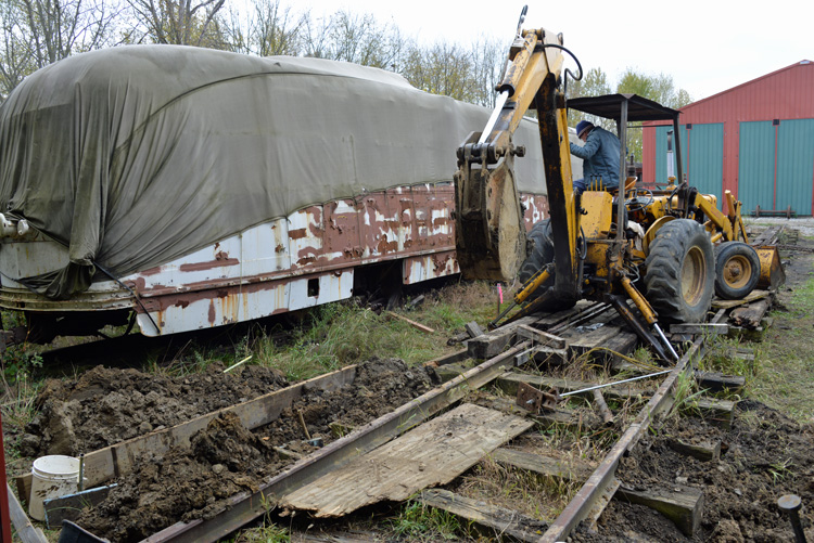

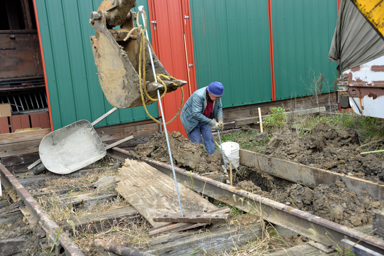

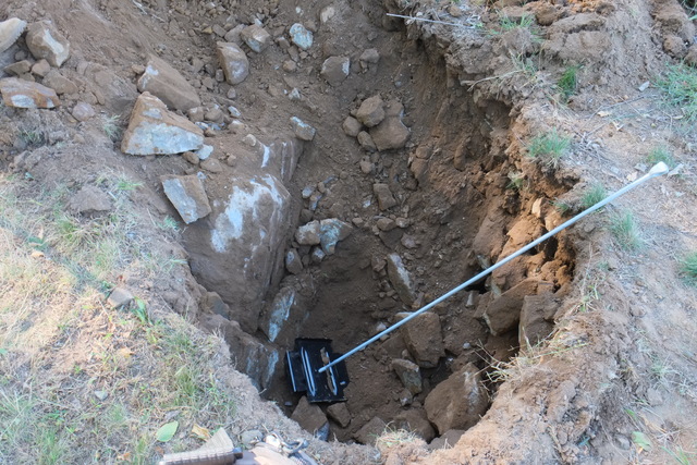

First off congrats on getting wire to your new buildings at Shoreline. It is a nice feeling to see infrastructure projects moving along. I'll have to revisit to see that someday.
Your point about joiner bars is well made, but in our application I don't think it fits. The joiner bars being used are some stuff the museum acquired many years ago and matches to some really big mainline stuff. I think it matches to 131lb or 140lb per yard rail. I don't know anyone with that weight rail in a museum. It was discovered during a recent property cleanup. It was determined to be nothing we could use for track and was heading for scrap when our overhead dept. grabbed it for its new purpose.
The current anchors are a 3ft joiner bar and a 2ft joiner bar paired up in an X configuration and a tie plate to make up the anchor. The first 3 installed were two 2ft foot bars paired up with a tie plate. I checked your anchor out on line and found it has a surface area of 150 sq. inches. The 2ft anchors paired equal that. The 2ft and 3ft anchors exceed that by at least another 50 sq. inches. Add the concrete and these anchors are going nowhere.
A few bags of concrete is not that expensive and probably justified given our potpourri of soil conditions. In places we have clay a few feet down. Other spots on the property are a mixture of silt, decayed vegetation, gravel, sand and other soft stuff. We are at the shoreline of an ancient Chippewa Lake. We are talking in terms of thousands of years of geologic history. The footers for our McCarthy Carhouse go down 12 ft. to get to firm enough soil to support this pole building due to this ancient shoreline and lake bed!
I know of another electric railway museum that used oversize former Lehigh Valley tie plates for their ground anchor plates. So improvising has a precedent! Using these joiner bars made economic sense. We would not have generated enough from scrap sale of the bars to pay for new commercial ground plates.
The helix screws you mention could have been another option, but would have been a further expense to have the contractor do them. We can do the current method using volunteers and our own equipment, our backhoe. Budgets are tight and I think everyone can relate to that. We often repeat a quote from the museums senior founder Anson W. "Red" Bennett, "We are playing a millionaires game with pennies!"
Thanks for the info, I will pass it on to the overhead dept. At some point we are going to run out of oddball size joiner bars and will have to come up with another ground anchor solution. Perhaps then it will be time go commercial.

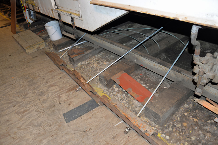

File comment: Digging the hole using the Museum backhoe for a ground anchor.
File comment: Overhead manager Chuck Legree is checking whole depth. The anchor assembly can be seen in the center of the picture.
File comment: Next batch of anchors being assembled. Tie plates to be used are on a tie end on the left side of the picture.

Yeah I didn't realize you were using bars that big and in pairs. I'm sure that will work. Just make sure
the rod is in line with the pull, and the bars/plates are perpendicular to the rod.
If you are in really soft soil, the ground anchors may "creep" as the load is basically compressing a big
wedge of highly compressible soil. Eventually it will stabilize. Allow for this by leaving some adjustment
room on the down-guy. If you are attaching with 3-bolt clamps, this is automatic, you can just
loosen the clamp and take up on the guy (put one end of the come-along on the loaded guy and the
other on the "tail" beyond the clamp). If you are using pre-form guy grips, leave the last two turns
un-done. This will let you unwind it (after bypassing the load of course), take up on the guy, and
re-wind it. They are rated for 2 re-uses.
