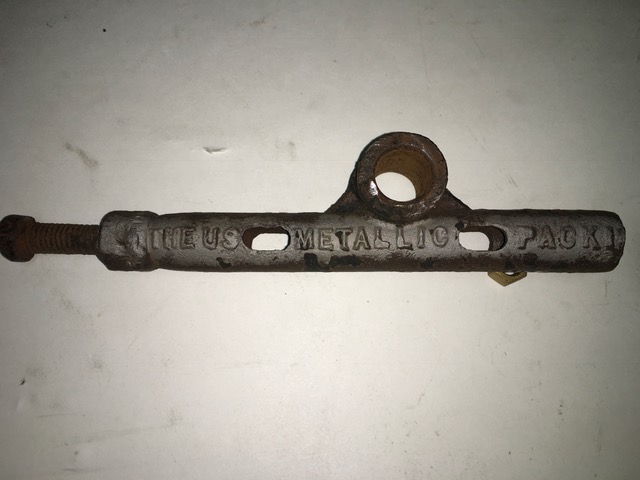

Has anyone ever seen installation/setup literature for these bell swingers?
Deteriming the length of the pushrod and angle of the pusher bell crank in relation to the bell yoke?
The Gollmar patent drawings all seem earlier than the one on MEC 470.
Haven't figured out what the two pair of slots are for in the housing of the pushrod.
The slots are not very long. If they are for pins or screws to prevent the push rod from departing the housing they wouldn't allow much adjustment with the bolt at the top. Was the idea to fit the pushrod length and get it adjusted for proper operation then drill a hole in the push rod thru these slots? Were they to also allow oiling?
Bob D.

The big problem I'm having right now is getting the cylinder apart. Being a blind assembly I can't get any force working in my favor. At this point it is pretty full of penetrating oil that seeped in thru the intake port. I'm going to try plumbing a grease gun to it and see if it will hydraulically jack apart.
