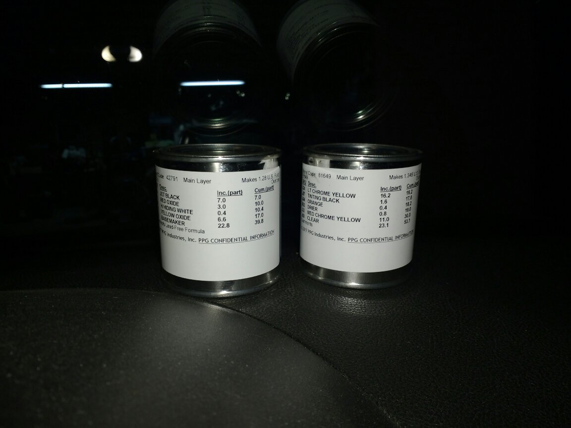

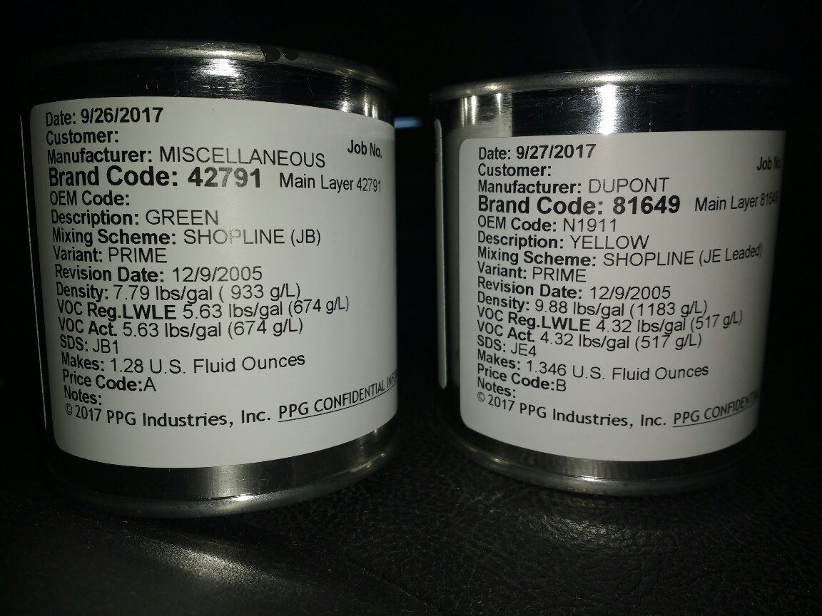

Dennis,
Here's the label info off the samples.
Bill

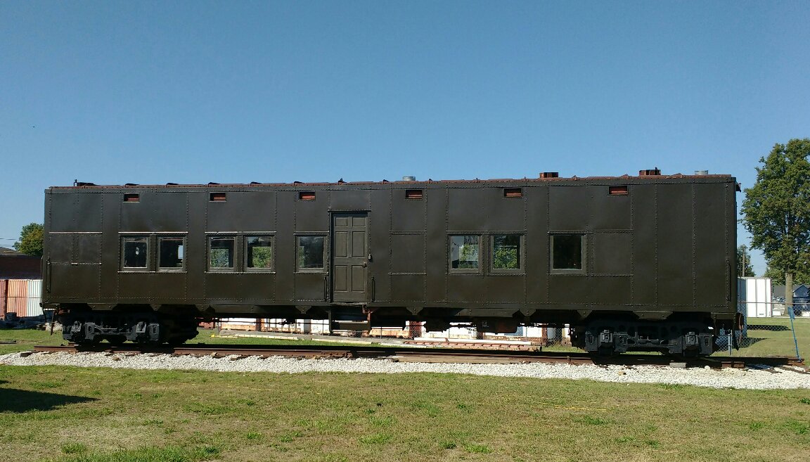

A little darker.
Bill

Location: Danbury, CT
The second attempt looks pretty good to me.
Randy Patterson
RMNE/NAUG
 Post subject: Re: Pullman troop sleeper color test
PostPosted: Mon Oct 23, 2017 9:53 am
Posts: 2077
I'd agree. The first version looked more like a weathered color. This looks much closer to what fresh Pullman green should look like. Sure would be nice if there was a drift card to compare it to.
