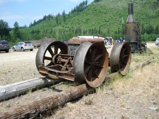

A pole road conversion survives at the Mt. Rainier Rail road & Logging Museum in Mineral, WA (formerly the Mt. Rainier Scenic Railroad). It has large double flanged wheels, and was made to run on telephone pole sized logs, which were used as rails. Here's a photo from circa 2007:
I know where there's about six pole road wheels sitting in a field. Personally, I'd like to see an operable, ridable replica pole road built in my lifetime.

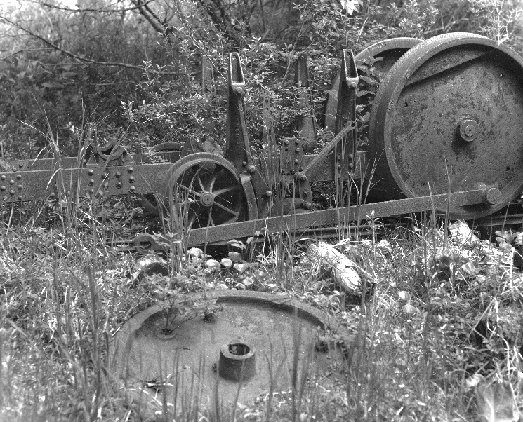

The Pinta Bay Mining Co in Alaska had one on a 5-mile narrow gauge tramway. The frame and wheels are still at Goulding Harbor, the engine was pulled off and moved to another mine.
Lesser Known and Obscure Railroads of Alaska
Funter Bay History

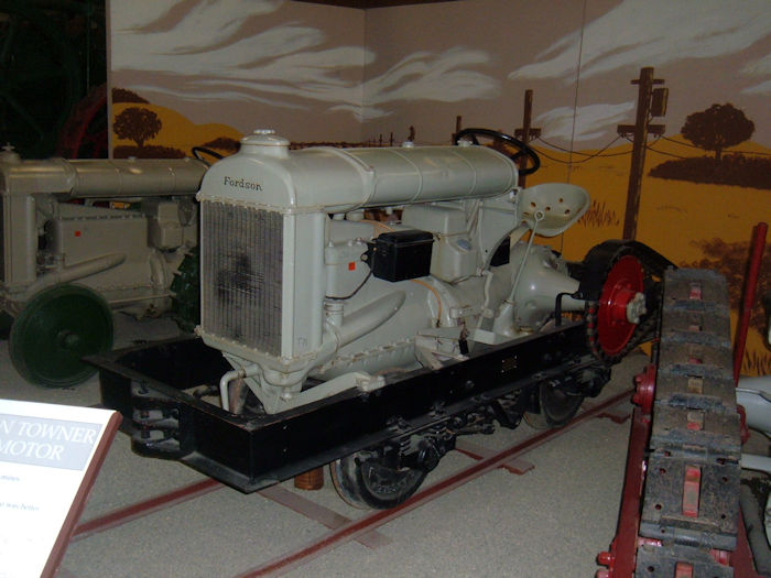

Since this thread came back up I have a photo to post. This photo was taken in June 2013 at the California Ag Museum in Woodland, California (about 15 miles northwest of Sacramento).
File comment: Seen June 2013 at the California Ag Museum
From the on-line collection guide (and a separate photo of the signage):
Fordson-Towner Locomotor 1924
This Towner attachment pulled three to four ore cars in mines around Placerville. CA. This attachment sold for $750. H. F. Towner was better known for his tillage tool business.
