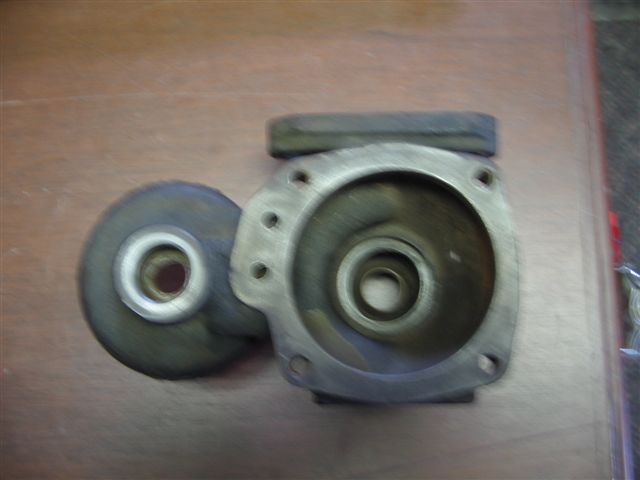

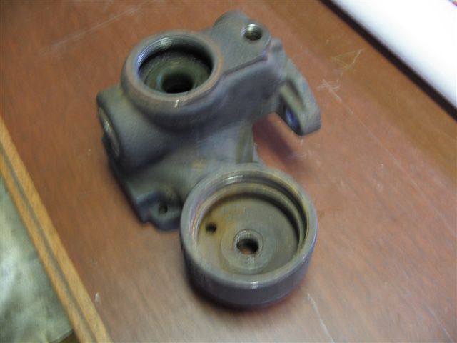

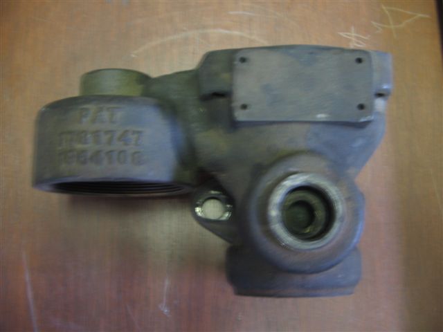

Does anyone out there have an idea of what type valve this is? I have been able to find the patents, but the description is somewhat generic. I apologize for the poor quality of the images.

looks like a triple valve, maybe a type "p" from an old passenger car? I've seen two types, "L" and "P". L's attach directly to the brake cylinder, I don't think the P's do.

Personally, I think this resembles a feed valve bracket moreover than a L triple valve. I could be (and most likely am) wrong, but I hope this provides some direction for you Wayne.

Not an "L" valve. Looks to me to be some sort of ancient feed valve, perhaps mounted directly to the automatic brake valve in the cab.
And am curious now about what it really is...

From what we can tell it is a feed valve. What type is the question.

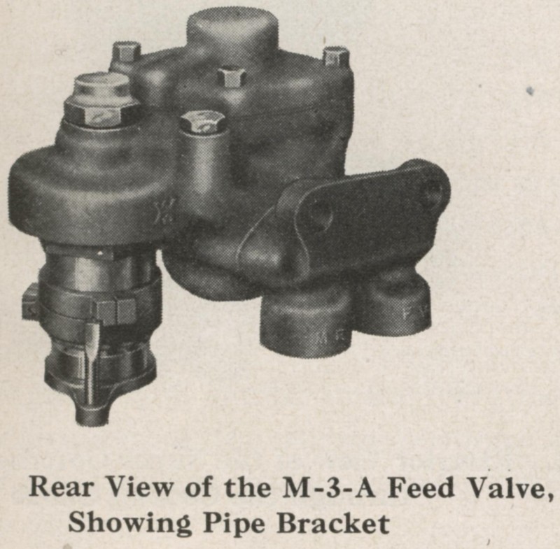

I too will put my money on a Feed Valve. Here is a photo of an M-3-a feed valve from a Westinghouse 6-ET booklet.

We are hoping to identify the type of valve in the interest of finding a parts list and other information regarding its function. It is, of course, a feed valve of some type. Nearly all of our equipment is equiped with M-3 feed valves, and a few older pieces having the B or C type valves. This valve is more modern than any of these, although it's outward appearance is very similar to the M-3. I cannot find any information in our collection that shows a picture of this type of valve that would aid in its identification. Any help would be appreciated.

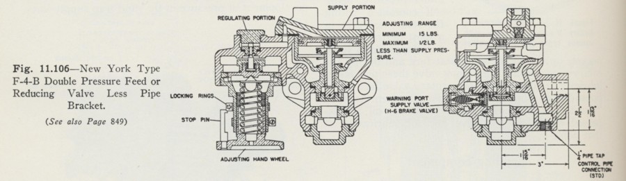

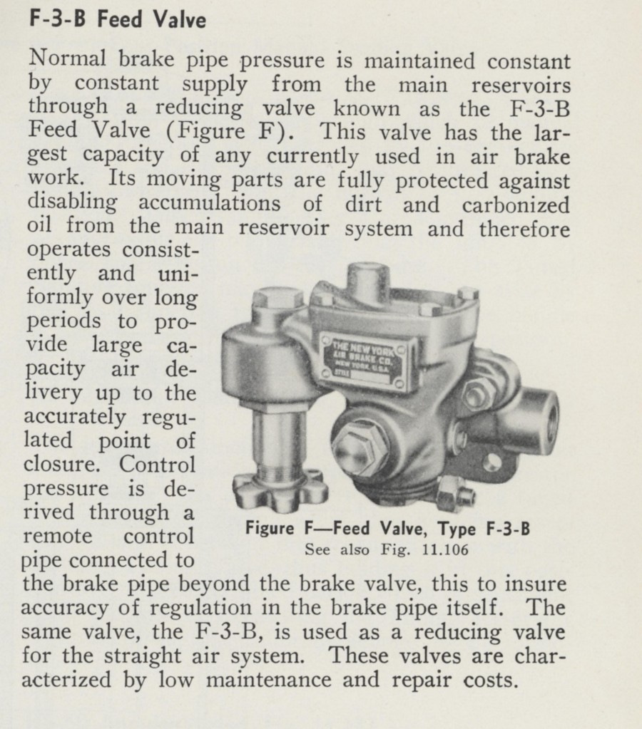

It looks like the body for a F-3-B single pressure or an F-4-B double pressure feed valve The New York parts catalog says they use the same body. WABCO part #501187 NYAB part #EV-2180.

Here is what I was able to dig up on the New York Air Brake F-3-B and F-4-B Feed Valves

My guess would be that this feed valve bracket came off a NYAB 14 EL stand. Brendan, did you happen to strip this off the 9331? Just curious, as it seems that this type of feed valve was associated with 14-EL brake equipment found on older diesel-electric switching locomotives.

F-3-B it is. I thought that may be the case, but seeing as the NY air brake catalog in our shop is missing the sections on the F3 and F4 valves, and interestingly enough skips right to F6, I could not verify. This valve is one that we had in storage in our "boxcar o' brake valves". 9331 is equipped with M3 valves and 8618 has a D-24-B. The use of this valve will be in a non-standard application, probably not worth the time to describe. Thanks to all for the information.
