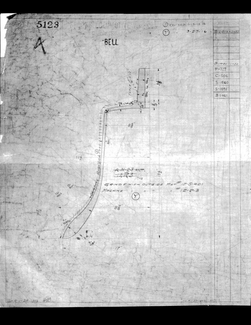

I don't have any information on this image other than it's a bell and it says at the top that it's from Brooks (It's slightly clearer in the unreduced image.)
